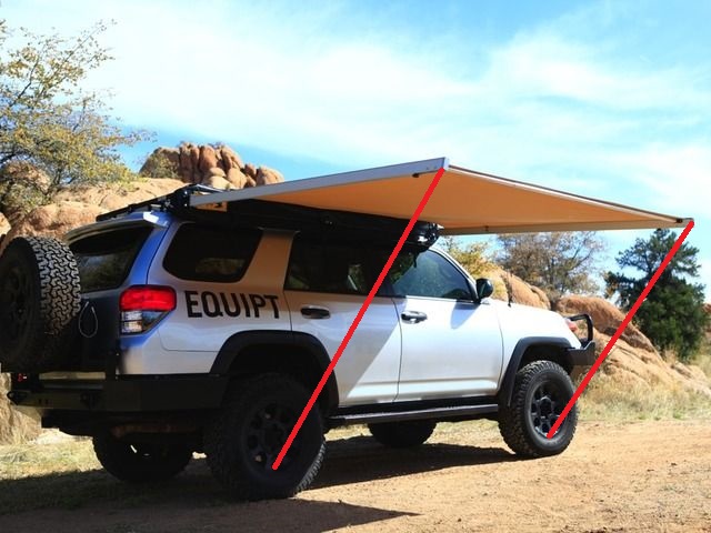

One other alternative for a parking lot - have you ever heard of a whoopie sling? Get yourself a length of dyneema rope and make two whoopie slings. Then attach from the outside corners to your sliders or wheels. Any rope will work. Dyneema is great because it's very low stretch and very easy to work with in terms of making easy tightening rope ends like a whoopie sling. But a couple tie down straps would work pretty well too. The nice thing about the dyneema sling setup is that they would also work for any other sort of tie down or anchor you use. And can be very thin and light and fit easily in the cover - so you don't have to take them off.

just use some coordage and a tautline hitch knot
(or truckers hitch if you want a better quick release)

Great idea. Just pulled a set of whoopie slings off my hammock and will repurpose on the awning.
