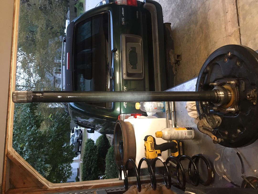

Many thanks to [MENTION=44220]BigFishAllDay[/MENTION], @MBTIM, and [MENTION=78997]Drcoffee[/MENTION] for all the great info and video. Completed passenger side and at 1K miles with no issues. Have passenger side leaking on the 1999, so am glad I bought the HF 20T.

Video and information is awesome, if I planned on keeping this particular rear end in my 4Runner I would have replaced all parts. It was pretty easy to get to this point and the video and write up were great to look at prior to starting
Got axle in and noticed the chamfer was on the seal side so I assume the seal had never been replaced. Noticed a little slop in the wheel bearing but didn’t replace anything besides the seal. Used the grease method and the seal sat a good 1/8” past the chamfer. I think It’s going to seal.
Put new lube in the diff and ran it on jack stands in low gear for about a mile per the odometer and no obvious leak yet and also pulled the abs sensor out and didn’t see it slinging lube so crossing my fingers it’s good to go for a little while.
Been driving daily and have put closer to 200 miles on the axle seal I replaced and no noticeable leak. So far so good
