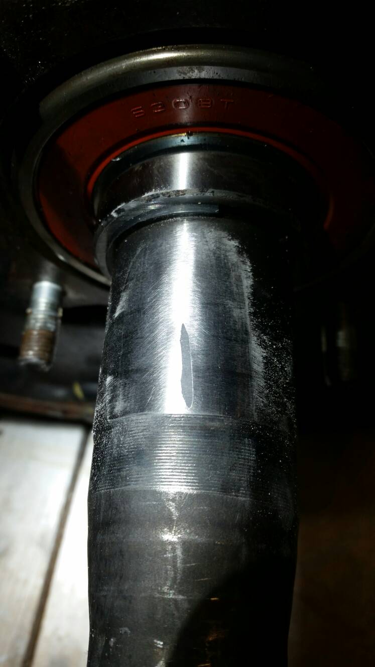

I know some people are nazis for doing the job properly, myself included (which is to replace the bearing entirely). However, I do understand the concern that to replace the bearing is a PITA especially considering that you need the special tool and if you take it to a machine shop you risk them nicking the axle when they cut off the retainer.
Replacing only the seal is cheap and easy. If the bearing doesn't have any play, IMO it is completely acceptable to just re-grease the bearings insitu by popping off the grease seal. As long as they have grease and there's no dirt, bearings last a very long time.
However, one IMPORTANT fact being overlooked here is that the new OEM seal design has the sealing lip recessed inboard. Flipping the retainer is not necessary, but you should move the retainer 1-2mm further inboard or else it will leak again. You'll see if you do the grease test. It's pressed on the axle pretty tight so I'm not sure how you could nudge it over without a press (maybe very gently with a hammer + striking tool?).

I got my axles nicked when i went to the machine shop.

Just replacing the seal is no big deal, as long as the race the the seal rides on is in the right spot. The bearing presses on like normal, just press it and retainer until it bottoms out and install the lock ring. The abs ring and retainer have to be pressed an exact distance from the end of the axle(or about 2mm of machine surface showing on the inside) or the seal will leak. Because these rigs are older and there are a bunch of young mechanics who can't read directions, what happens is the abs ring and retainer gets pressed all the way to the lock ring therefore the seal is ineffective due to it having no race to ride on. before changing only the seal and packing grease in the bearing, before taking the axle out, remove the ABS sensor and look into the hole to see if that abs ring is center, or slightly toward the carrier from center if it is all is fine just replace the seal. If the ABS ring is off center towards the wheel bearing you and just cut off the ring and retainer and press new one on into the correct spot, if the bearing makes no noise just pack it with grease and be on your way.
