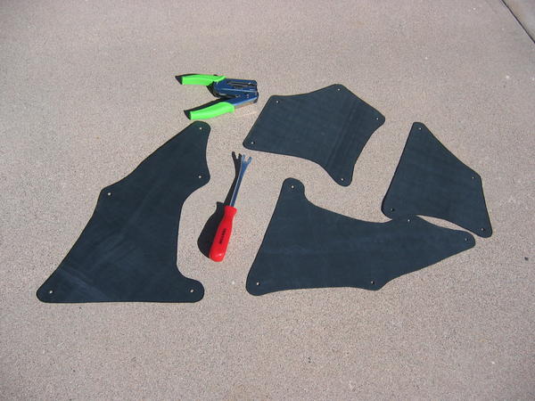

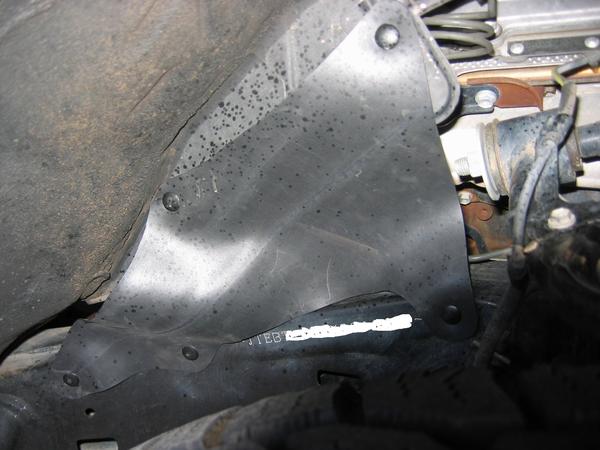

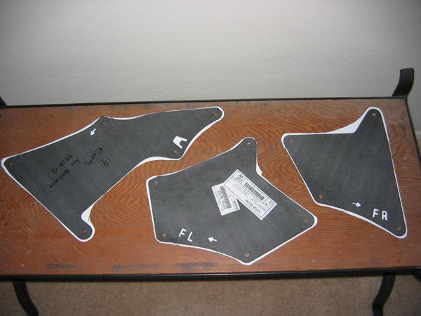

Second, I had to replace the inner fender splash guards since there was only one left and that one was two shakes away from getting torn off. I found place online that sells roofing rubber in 1' X 10' sections. I downloaded the pdf for duplicating the factory ones and transferred them over. I wanted a little extra material in certain areas so I cut them out like you see in the next pic.
I had a hell of a time getting the old fasteners out so I bought the tool you see in the next pic. Popped the rest off in less time it took to take off the first by hand! I think it was ~$5 on Amazon and will get used next time! Also got a hole puncher.
I got the fasteners from Ace Hardware: part # 4818-Q @ $.75 per. I had to go to three different stores as each one didn't have enough. I started putting the guards on and found out that these fasteners are really snug. I also found out the hard way that they go in better if they have been lying in the sun and have been warmed up. The side that was shaded, I ended up snapping several of them. Back to Ace for more. I filled a cup with HOT water, left them in it for a few minutes and was able to push them in more easily, even the ones that had been in the sun.

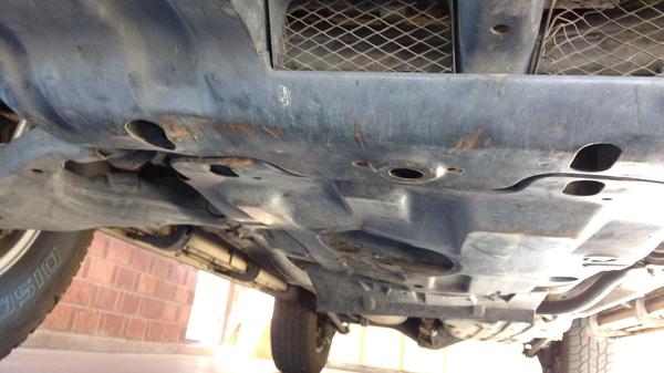

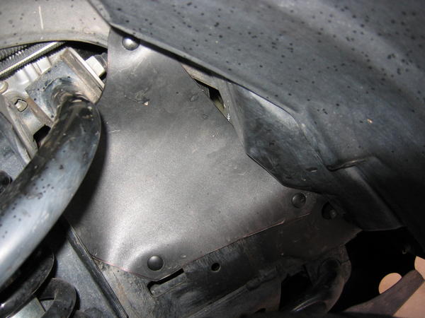

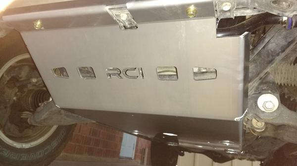

I Installed RCI's skid package a couple days ago and thought I'd share. The old stock plates were bent up by the previous owner and also made the plastic transfer flap hang down at an odd angle.
The hardest part was getting the transfer case was getting the crossmember installed. Be prepared to massage the fuel tank protector with a hammer to get it to fit (see pic 1). A quick call to RCI was answered and I was told to do this. A jack comes in handy to lift and balance the member.
One of the edges of the plate had to be cut off since it was hitting an exhaust hanger (see pic 2) and that was not allowing the bolts to be tightened. Doing so would have forced the exhaust pipe upwards. I assume this is due to Toyota installers at the factory making the welds and something like exhaust hanger welds are not going to have the same tolerances like an engine. A cutting wheel and file took care of this, though it still touches...will take care of this the next time it comes off. Mark and measure once so you don't start grinding off the wrong corner like I did! Bolting and unbolting items like this and crawling under/out from under the truck many times is a pain and I'm not the young fit Gumby I sort of used to be!:D I gotta get one of those impact drivers!!
Everything else pretty much went into place once I finished with the transfer case plate. Again, the jack with a piece of wood under the front and trans plates made it easier for the bolts to get started. Two people would make this easier, but it is possible by yourself.
Overall, I do like the new skids. They are really nice and since I'm not a hardcore off-roader, the aluminum will give me all the under carriage protection I need. I may even be able to remove the oil filter without removing the front skid. A Form-a-Funnel might do the trick...we'll see.

Old:
New:
