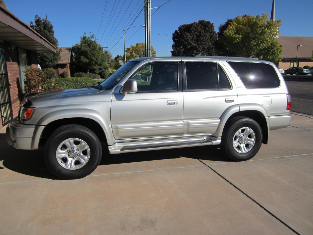

2001 Toy4R Limited , bought 3 weeks ago, 108k miles from an elderly couple for 6800.00 !! God Bless "Our" Elders !! Never seen dirt road, zero rust , zero chips , flawless w/ all Maintenance done.

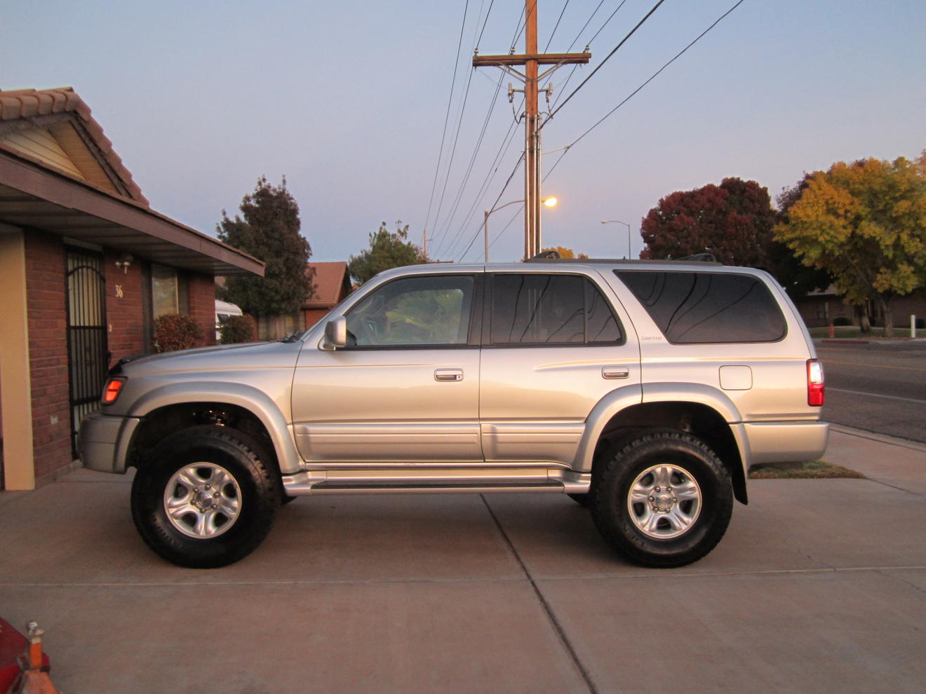

Just installed the following : 3" 2.5 Fox Coilovers Front , Front Upper Control Arms from Toytec , Power Steering Rack Bushing kit installed.
Rear 3" Fox 2.0 w/ Resivoirs , 3" 891 OEM Springs from Toytec , Rear Upper Control Arms , Rear Pan-Hard Bar w/ 3" drop bracket , 1" Diff drop .
Suited w/ 285 75R16 grabber AT2's !!
Next project . 4.88 Gear swap w/ front/Rear ARB's and Tranny cooler .

Nice start man, lets see some shots of the suspension. I dont think ive ever seen a fox 2.5 bodied coilover on our trucks. And i want to see how you mounted your rear resivoirs.
Thanks . Been anticipating this install for 2 Months , is how long it took Fox to get my order to me . Was considering the Ultimate Lift from Toytec , but 2 friends of mine had the same Lift on there Toyotas and the Shaft has had a tendency to break . Noticed the same problem w/ others as well, is why I went w/ Fox's shocks . Will get around to get more pics of the setup ,as I'm ordering Wheel Spacers for all 4's , until I decide wheels w/ a offset ,as I'm noticing rubbing on the frame a little bit . May do a 1" Body lift we'll see .
