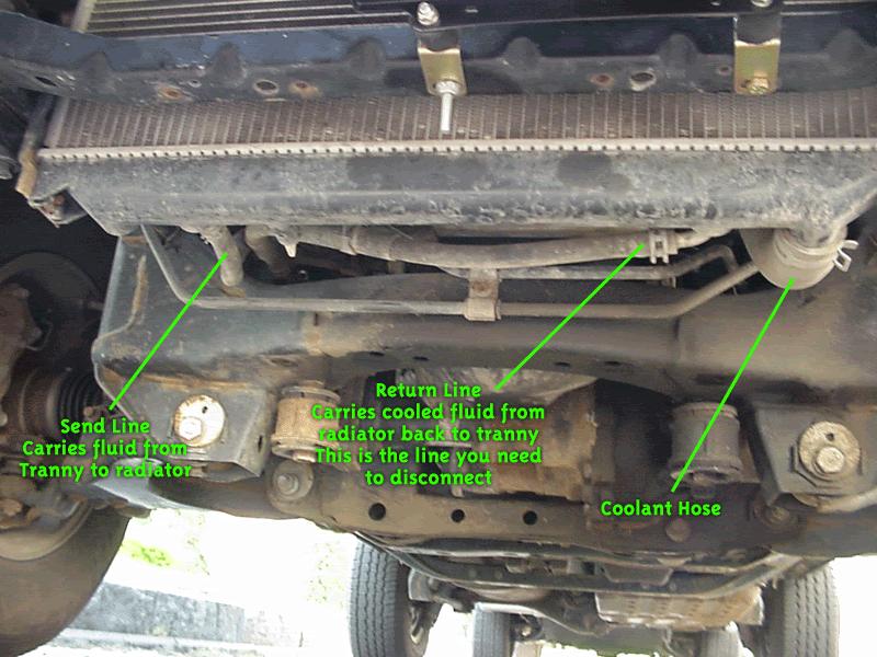

Does anyone know which steel line is the send and which is the return? I'm talking about laying under the truck, looking at them from the front.

Here you go.
