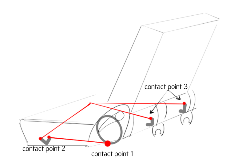

Function:
The back seat latch release is initiated by 3 contact points or junctions.
  • Contact point (1) is located at the handle to release the seat. Two cables are pulled at this contact point, one cable releases the upper part of the seat. As the upper part of the seat folds forward, it tensions a lever that pulls a second cable. The second cable is for the two latches that secure the base of the seat - It pulls the lever at the next contact point (contact point 2).
  • Contact point (2) is located at the side mid of the seat, beneath part of the yellow warning sticker at the base of the seat. This contact point is another lever that pulls a cable. This lever pulls the final contact point (contact point 3)
  • Contact point (3) are the final levers that release the latches to the back seat, so technically there are 2 contact points here. Between contact point (2) and point (3) the cable splits into a Y. From here the two cables release the final latch mechanism that holds the seat down.

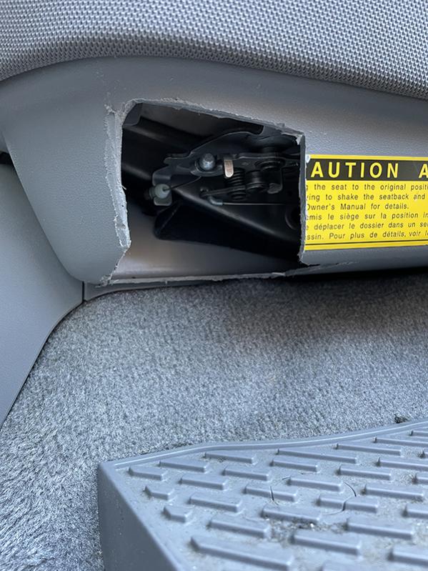

The final Mod (function over looks):
I cut a hole on the bottom side cover of the seat in order to access Contact point (2). Pulling the lever at this point will release the back seat. If the seat ever gets stuck again, all I need to do is use my hand to pull this lever and release the seat.
