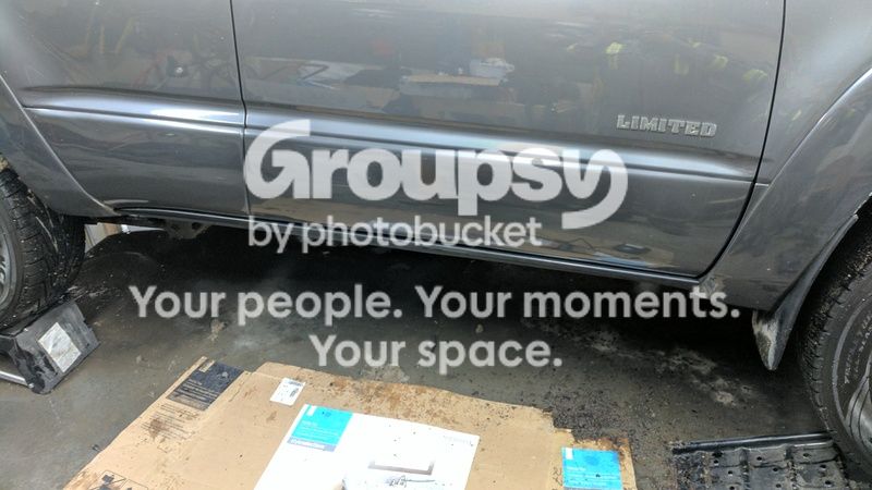

So, here I am, back with a 2003 Limited. Already dealing with the annoying little problems, like a cracked windshield and HVAC lights that were burnt out. Couldn't get the key fobs to work. Tried new batteries. Then I realized that the clock was also constantly resetting to 1:00 every time I started it up. No dome light, either. Surprise, surprise, they're all on the same fuse. New fuse, problem solved. For three days. Then today, no dice. Put a new fuse in, blows as soon as it hits the contacts.
Sonofa...

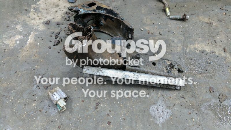

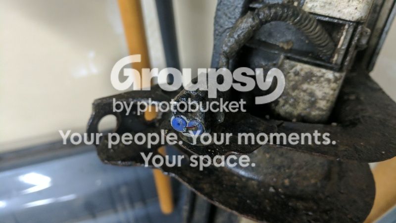

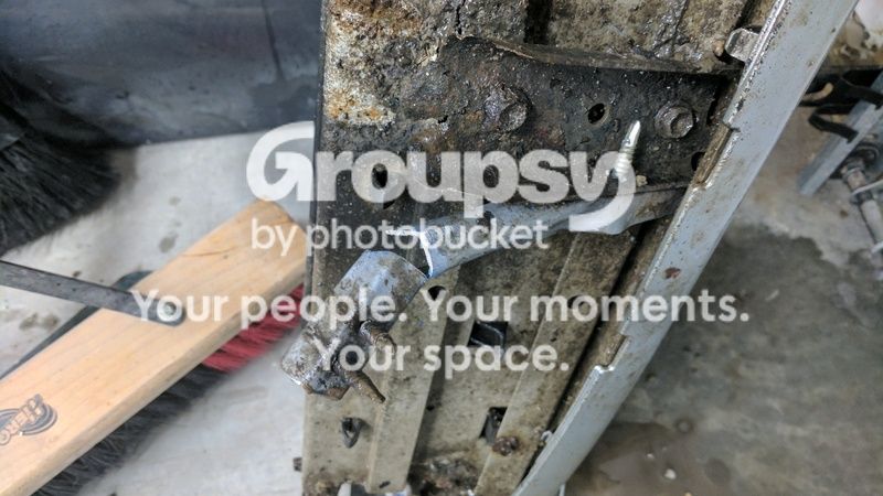

Fuse also handles the running board lights. They've never worked, even with the new fuse (when it worked). Up on the ramps, crawl underneath. Sure enough, the wires are pulled out of one plug, and very, very brittle on the passenger side. But that's not the best part. The best part was finding both front brackets completely rusted through and a Mickey Mouse repair job done, just to keep the boards in place.
Sonofa...
Now the 4Runner is 100% running board free.
