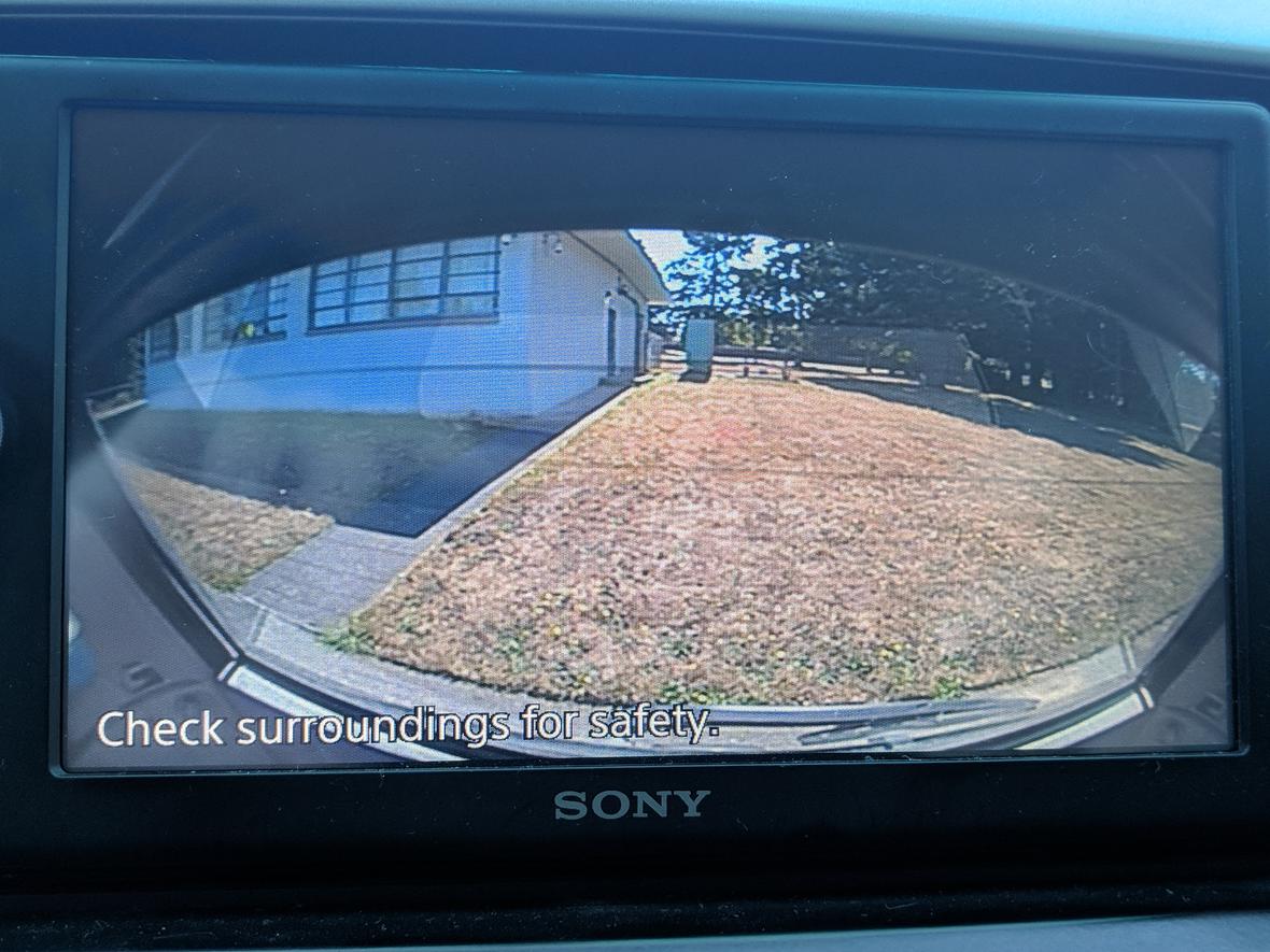

Took some screenshots; forgive the poor quality (pic of a screen will do that) and lighting (the sun came out between the 2nd and 3rd pics and these cams don't do contrast well).
The target is my car wash bucket, and for reference, it's about 14" high and 16" wide.
Target at 10 feet:
5 feet:
2 feet:

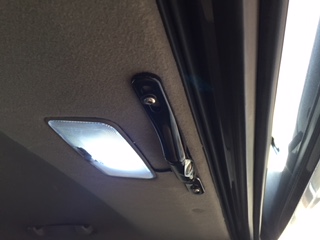

Here's what my headliner mount looks like, and the view I get. Although I do like the bottom of spoiler idea.

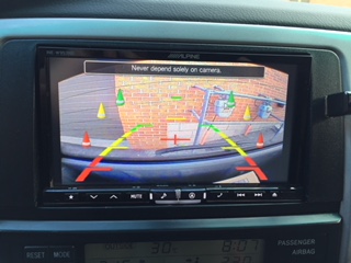

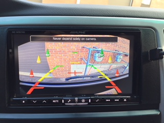

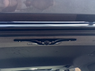

Having said that, I mounted mine inside in the head liner as well.
License plate style so I can pivoy the lens.
It's not perfect no but the best part is never having to clean the lens.
Auto adjusting so with my tinted windows so there's no exposure issues.
1st pic is window up, 2nd is window down.

^^ that's not actually bad. I may have to rethink my under the spoiler location. I'm on camera #3 now in a year, but luckily all replaced by the vendor.
Maybe placing it inside will help it last longer. And I would no longer need to clean it off during winter.

I used the license plate version because it allowed the ability to rotate the camera barrel to the best viewing position. You can't do that with fixed mounts.
Also as it's inside, you don't need anthing expensive as it's protected from the elements.
