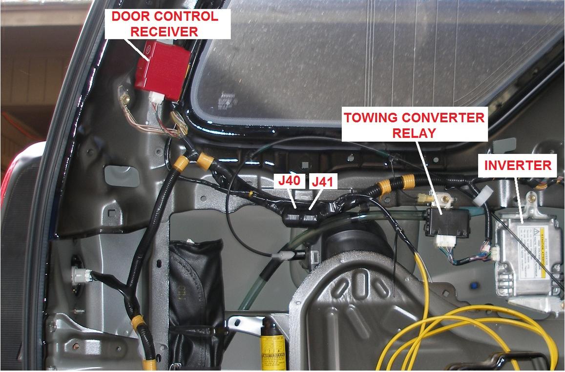

If there's no power there, check continuity at the junction connector, J40/J41, which is located in the cargo area, driver's side wall under the window. I've included a picture to assist in locating (I marked what I believe is J40 & J41). It's obviously good up to that point since the other side is working.
