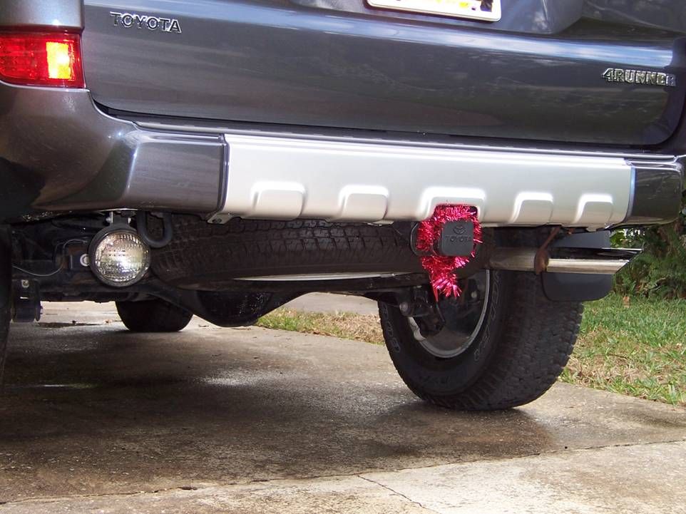

I put a light under the back of my rig. I used one of the $10 rubber housing farm/tractor type lights form Pep Boys. The bolt fit perfectly in a free threaded hole on the drivers side frame in the back. You can adjust it up out of the way when wheeling or point it side to side if needed. I put the switch in the blank space near the AC button left of the searing wheel. I can't post pix(too big) but If you give an e-mail I will be glad to send a few of my set up.

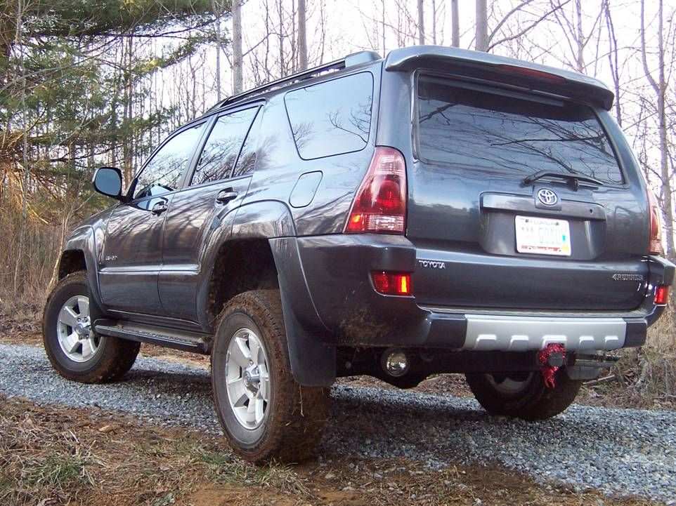

You can see it as I got up the hill. You may not be able to see it but I removed all the towing suff and tucked it up nice and clean. I think there was one other thing I removed but can rememer.

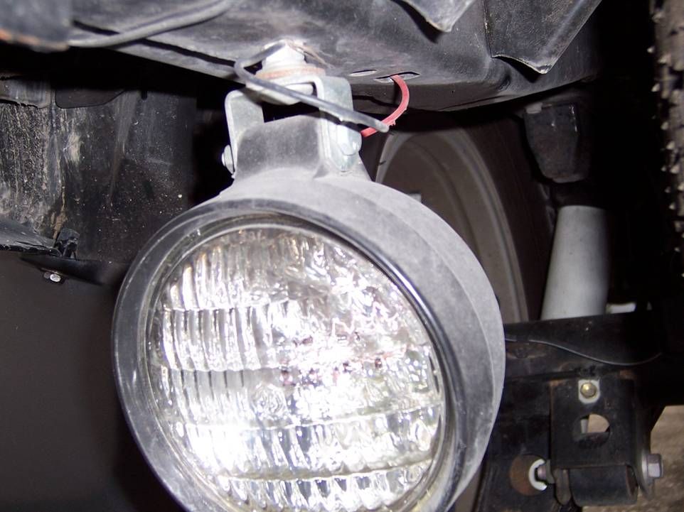

One hot wire and the ground is on the bolt. I have 2 identical lights on the frame just befor the doors facing to the side. Still adjustable so you can fine tune the light.

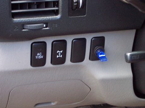

Here is the switch. Out of the way and off to the side. Lights up when in use. I have the switch for the front and side light in the 2 spots on the CC. Easy reach. Can you tell I am geeking out now that I can post pix!
