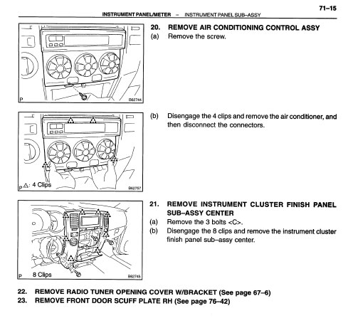

The climate controls / display panel are a single unit but are easily removed. First remove the screw revealed by opening the storage cubby. After that, you just have to grab ahold of the unit and give it a firm tug. It's attached with 4 or 5 nylon clips -- they're fairly resilient. Just go slow so you don't break anything.

Did the rep tell you how he cleaned the connections? With alcohol or anything else? or how many connections? I'll post the pics from the manual later so that anyone with the same problem can disassemble the panel.
The dealer might have used alcohol to clean it, that sounds familiar. As far as I know, there is only one plug, and I'm assuming they cleaned out both connectors. I'm sure if I wasn't under warranty they would have had no problem in ordering me a brand new panel.
This is what I found in the manual:
