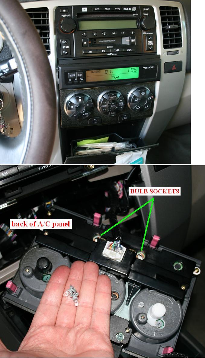

Took a couple pics with a green LED installed on one side. Looks great compared to the crappy orange color...I'd like to find a couple blue LEDs tho.
Quick and painless as mentioned in a previous thread. Back out the one screw in the little "cubby" and sort of pop out (I started from the bottom, where the screw was) the A/C panel. I labeled where the two sockets are for the issue at hand.
Might need to figure out how to get a resistor inline with the anode (longer leg of the LED, positive leg) to keep the heat/intensity down. I took that pic with pretty decent daylight and look at the brightness. During nighttime driving, it would prolly be a lil annoying.
Note: the bulbs can be found at radioshack I believe, but so can the LEDs.
Note2: you can replace most, if not all the bulbs on the back of this panel...I'm thinking about installing all blue LEDs.
I'll post more pics if I decide to proceed with LEDs.

So based on that, is it just a loose connection that causes it to flicker and one to be dimmer than the other? Looks to me like the panel itself doesn't need replacing if it's just a bulb/connection issue? If it's just a matter of a bad connection, maybe it can just be cleaned and some dielectric grease added to the contacts and the flickering/dim bulb issue will be gone forever?
Ricky
Ricky
Upon disassembly, I could see how the thin wires (two coming from the base of each bulb) may just be the issue in the "dimming bulb" issue. The way the wire wraps around the base could actually prevent the wire from even touching the copper contacts on the circuit board (because of the base's indentions). I'd recommend "unwrapping" the bad bulb, or both, and rebending the wire (so that it is raised off the surface of the bulb's base) forcing it to contact the copper surface of the circuit board. At the same time, you may want to take a pencil eraser and give the copper contacts a little scrub.
If the bulb is bad, it won't light, so the dimming problem probably has something to do with the mating surface.
Sidenote: you could pop out this panel inside of a minute (being generous) and do this little 'maneuver' with the wiring in another 5 minutes, by the way.

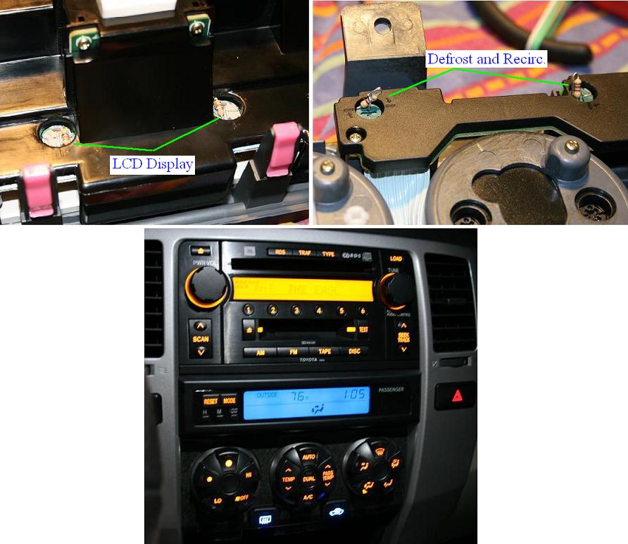

Blue LEDs installed!!!
I'm digging the blue LEDs, but the rest of the dash is still that orange/yellow/brown color. I may attempt more LEDs at a later date.
If anybody wants details on the LED's, resistors or techniques I used (I used quite a few), gimme a holler. In the meantime, have a great day and take care of your T4Rs.
