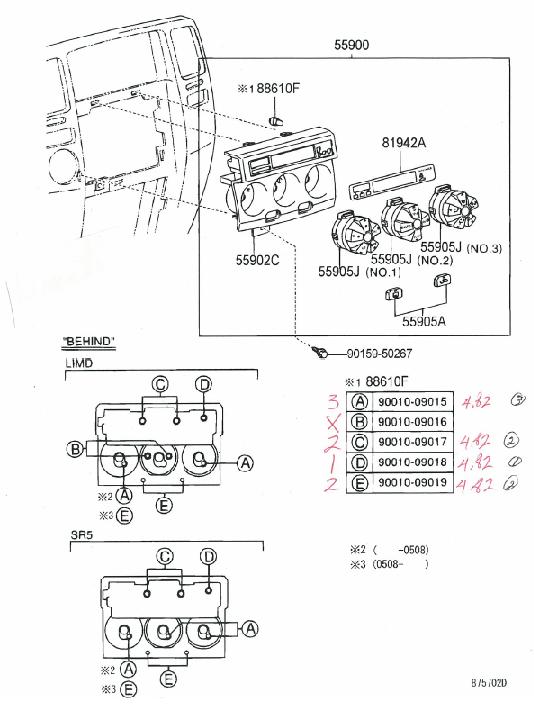

Replacement bulbs diagram
Attached is the diagram that will help you in replacing the bulbs behind your clock/info pannel/ac control in your dashboard.
This diagram shows where you can find the 8 bulbs behind the unit, the parts number, and how many you need of each part. I got this helpful guide from the folks at Don Mcgill Toyota Dealership in Houston. They were extremely helpful and I will most certainly use them again for my service/parts need.
Good luck everyone!

Hello, can you tell me wich part number is for what location ? I need the bulbs behing the info/clock panel
Good luck everyone!
Thanks
