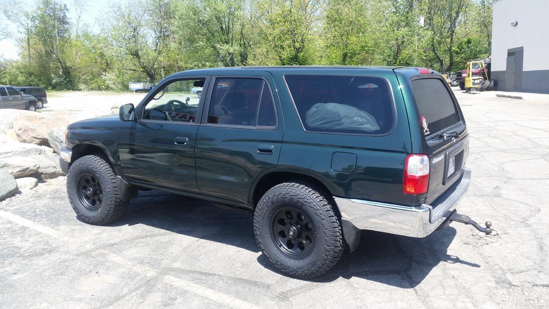

Mickey Thompson Classic III 16X8, 0-offset, 4.5 BS
Mickey Thompson Classic III 16X8 6X5.5 0-Offset, 4.5" backspace with Falken wildpeak at3/w 265/75/16 on stock 2001 sr5 2wd, no lift, saggy rear (about to fix). No rubbing, close (real close) but no rubbing.
