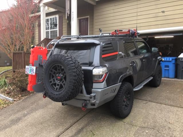

I bought a rear view camera from amazon and mounted it under the rear spoiler due to my using a swing out bike carrier. The license plate camera was blocked with the rack in place, I still have it connected into the rear view mirror. The new camera is connected into my touch screen stereo, Pioneer 2600BT. It works great, no info on temp ratings though. I am interested in a front camera as well.

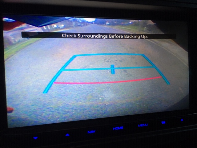

This thread is the closest I've been able to get while looking for answers to a couple of questions. I'm thinking about buying a junkyard OEM camera and leaving my current camera in place. I would mount the new camera on the underside of the spoiler, and (hopefully) use the existing camera wiring to just plug right in, since the run appears to be shorter. My questions are:
1. Can anyone show me what the view looks like from the spoiler when using a factory camera?
2. Does the proximity grid (blue and red lines) become useless then, or can it still be accurate if the camera angle is just right?

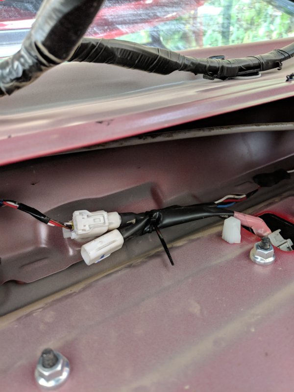

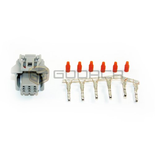

Here is the factory toyota connector that plugs into the camera. Just remove the factory camera and place it wherever you want. Build a harness with this connector running the wires back to the factory connection in the rear hatch door.
There is a short 6 inch harness that plugs into the factory camera as you can see in this pick that you can unplug, cut it in half and you have your splice point to plug back into the factory harness in the hatch.
I used about 20 feet of wire relocating to my C4 fab rear bumper running along sing arm. into a grommet under the floor where other wiring comes in, up the C pillar trim into the rubber boot that goes into the hatch door.
