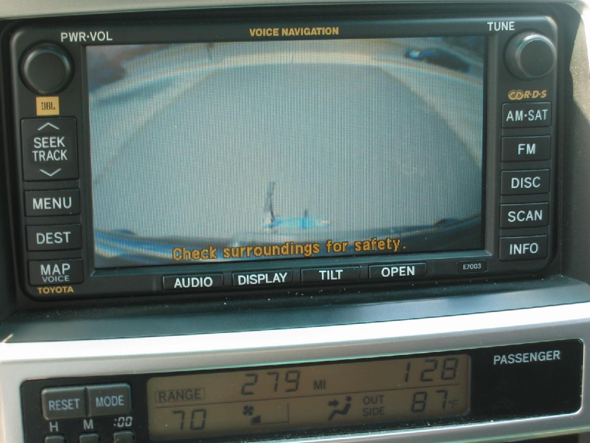

......As for the camera, I got it thru customer service at tweeter.com.........and due the the ease of installation, it is a no brainer. The 1:15 was total install time. There really isn't much to do behind the dash if you have the BEC103. Simply plug and play.

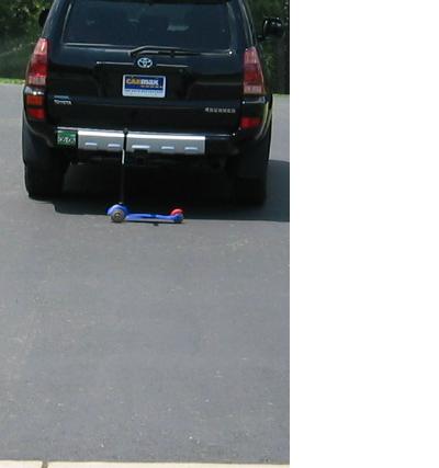

How much was it? Did it come with all the wiring you needed? Lastly, it seems to protrude from your spoiler....does that bother you at all?

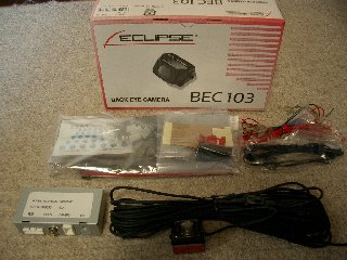

I bought the BEC103 at Tweeter for $220. It also came with a separate video unit to hook into an eclipse head unit. Since I have the camry nav unit, it plugged directly into the back of the nav unit. Plug and Play.
As for it sticking out, I don't mind it at all. I think the close up picture may be a bit misleading.

my camera was like $200 from ebay. I bought the pioneer nd-bc1 as it was a bit smaller than the others. (and was accessible at the time). my camera on the old vehicle only stuck out about 1/4" out of the bezel of the door. here are directions I used to install in the back door: http://www.siennaclub.org/forum/index.php?showtopic=3572&view=findpost&p=34907
and here are pictures of the install: http://vinny.tamu.edu/camera/
I liked my setup and will do the same again. it was a little more advanced of an install and took a bit of time, but I prefer it. jeff's install also looks good, but I prefer the door for two reasons. the first is that I didn't want it sticking out and visible for just everybody to come by and rip it off...and the second (and most important), I installed my camera so that I could back up to a trailer and not have to step out, so I wanted a clear picture of my hitch and ball. moving up to the spoiler, made it disappear partially behind the rear windshield wiper and also appear much smaller and harder to see.

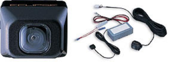

Does that mean you can use that "seperate video unit" to route video, say from a DVD player or laptop through it? Which part is the video unit?
Pic #1
I have the bec103 so pic #2. Basically, this camera is made to plug into the white adaptor in the silver box displayed in pic#2. On the other side of the silver box, there are rca video outs which would then be plugged into any head unit or monitor with a video input.
Rather than using the white adaptor on that silver box, since I have the Camry nav unit, I can plug the camera directly into the white adaptor of the nav unit. Simple Plug and Play.

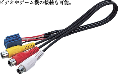

as for your other comment about dvd video. well, you COULD do that, however, the nav unit would require being put in "reverse mode" so that the nav thinks your backing up to see it. well. there is a group working on a module somewhere. I saw the link on siennaclub.org, lemme see if I can find it real quick...
yep...here it be...

I have a guy at Super Autobacs (Big Japanese/Worldwide Auto Store, that only has one location in the US and it is a short drive from my house) researching these same issues for me. If they will do it for cheap enough, I will definitely have them do the install. The mobile electronics manager said that soundgate is probably coming out with an adapter this month. He is supposed to get back to me in the next couple of days.
