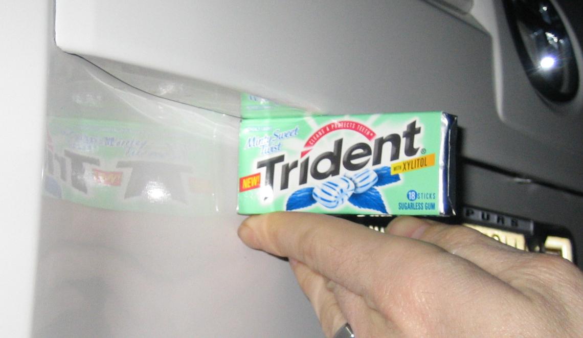

I have the 8120 and the CCD 2000 backup camera. I installed in the stock location just left of the rear handle (exactly where the notch is). the only problem is that if you want to completely hide it, you have to cut into the hatch itself because of the size of the camera. I didn't want to so it sticks out a few millimeters lower than the stock does. you still can't really see it. Let me know if you want some pics.

sorry for the delay.
IMG_0607.jpg~original
IMG_0611.jpg~original
Wow, that looks really nice. You can barely see it at all. I won't be cutting into my 4R after all. Thanks for the quick response and the picture. I'll have mine installed the same way, aside from the paint job I'm going to give mine. Thanks again.

I went out and looked at my lift gate and it looked more flush than yours. As though I would not be able to simply put in there w/o doing some customization. Is your 4R an 2008 SE? I don't even think that would make a difference because your is obviously a 4G. Hrmm, I'll keep you updated.

Flush how? Like you don't have enough room inside? Yup, 08 SE.
Hrmm, did you remove the piece from where factory camera goes? If so, I did not. I didin't even know you could. That may be why you have space and I don't. Here is a pics to help illustrate my point.
Yes, i removed the trim piece to cut out the notch and mount the camera. you have to take apart the inside of the lift gate to get to the bolts holding it on.
