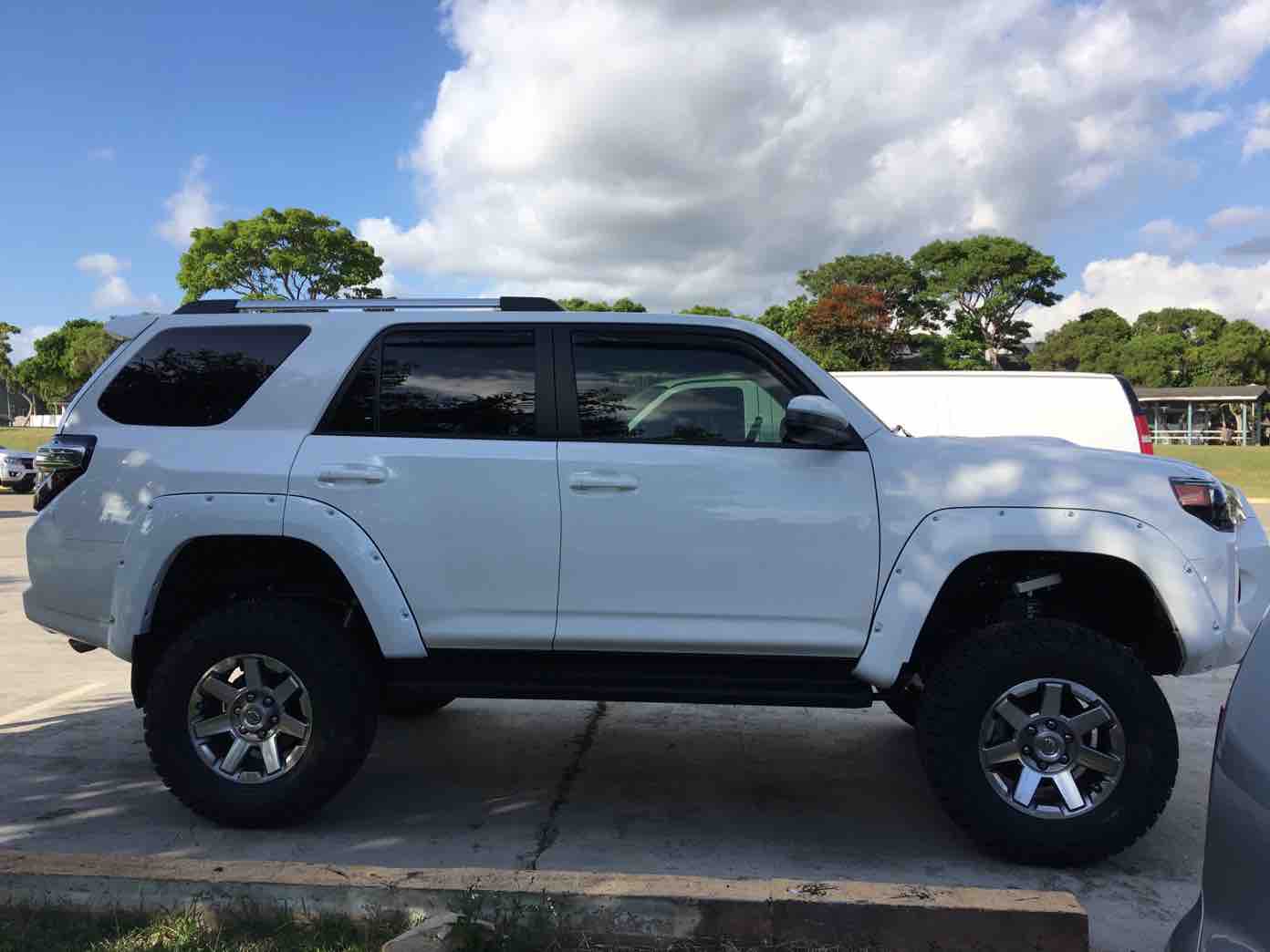

IMG_0402.JPG this is my co-workers 5th gen with a 8inch lift they used a fabtech lift but they charged him 2 arms and 2 legs lol... I don't wanna spend money on something I can do myself

It looks as if Fabtech has is the only one out there making the extreme drop brackets. If you put in your three inch, you bolt on another lift without issue. Unless they require cutting welding (I have no idea, never went into that world of lift kits) you'll be fine. Order and bolt it on.
