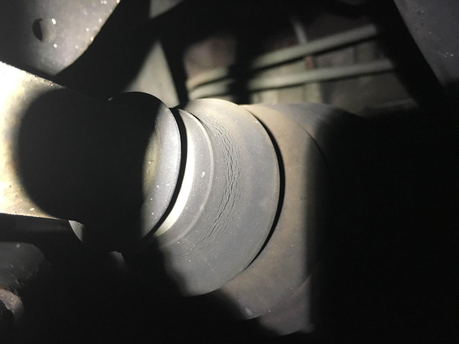

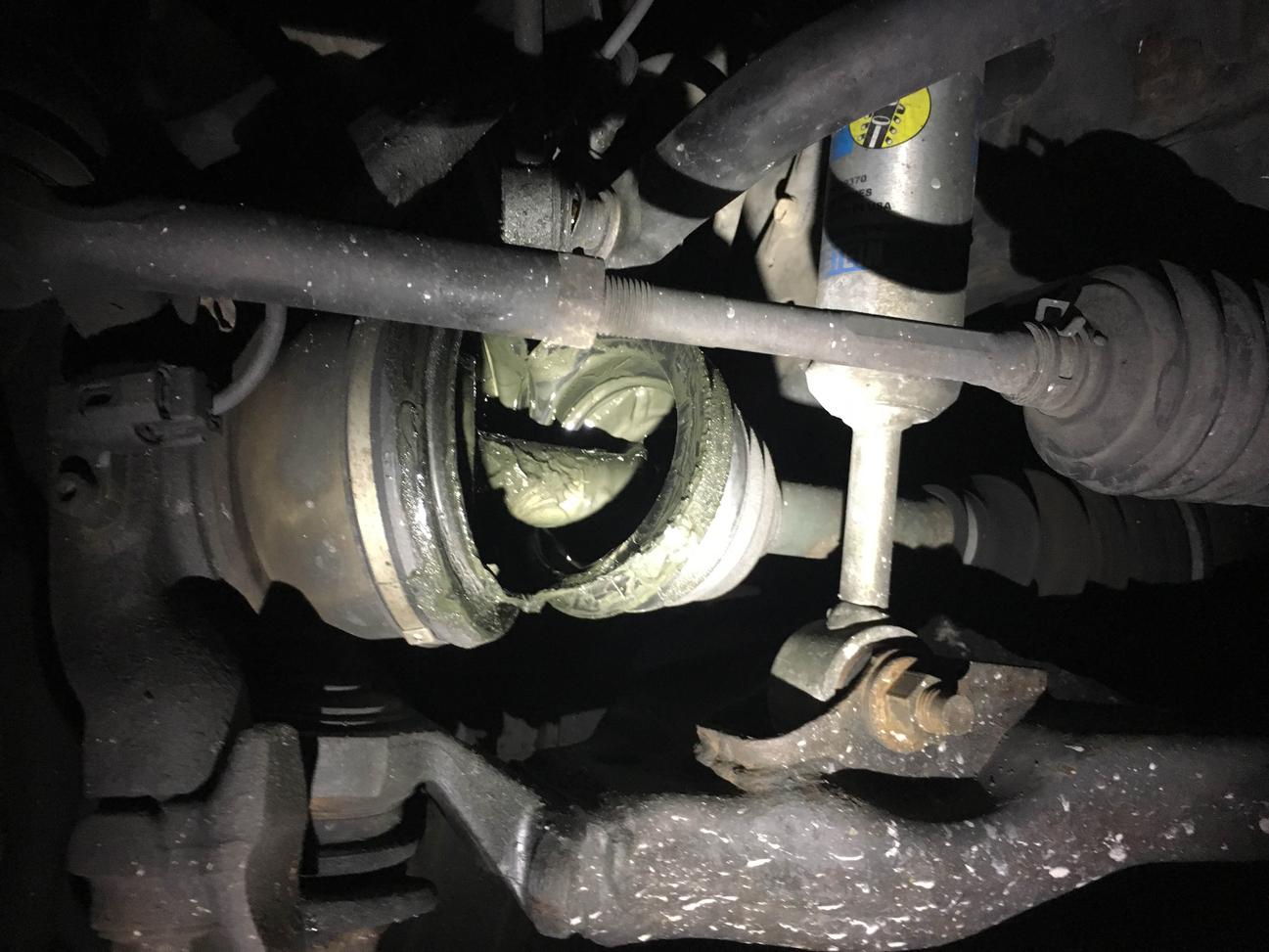

So i replaced both front CV shafts on my 4th Gen. The passenger side was done 8/2016, and the Driver side was done shortly after. I just noticed grease spraying inside the wheel well, and sure enough the passenger side outer boot is torn and leaking. I then inspected the other boots, and all the boots on both "new" axles are cracking.
It looks like the rubber material used by CVJ on my axles is of very-sub par quality. What complete peices of garbage, and a major waste of money. These have less than 30k miles on them in 2 years. Not driven off-road either.
Thankfully, i saved my OEM axles (which were completely fine other than torn boots). I have purchased the OEM Toyota re-booting kit, and I am working on rebuilding both original OEM axles.
I just thought I would share this for anyone planning to drop more than $400 on a set of CVJs.. save yourself the trouble and buy OEM or just buy the reboot kits (OEM of course)
who doesn't love pictures.

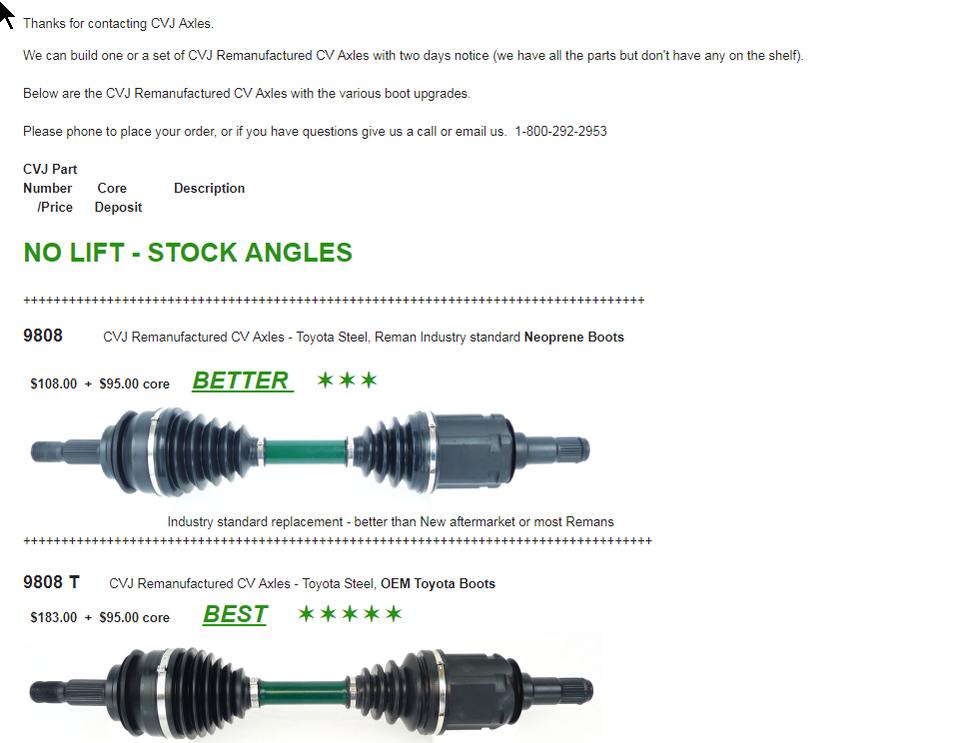

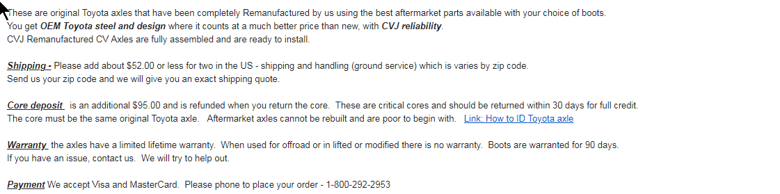

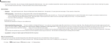

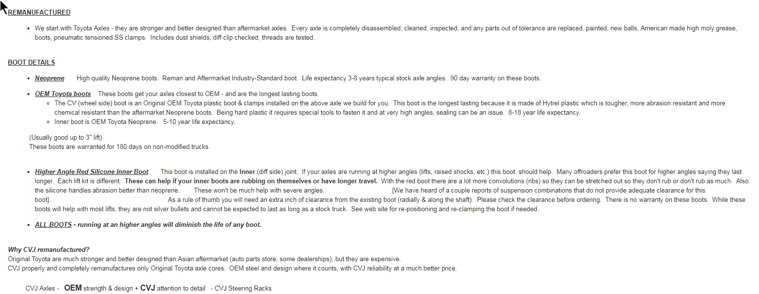

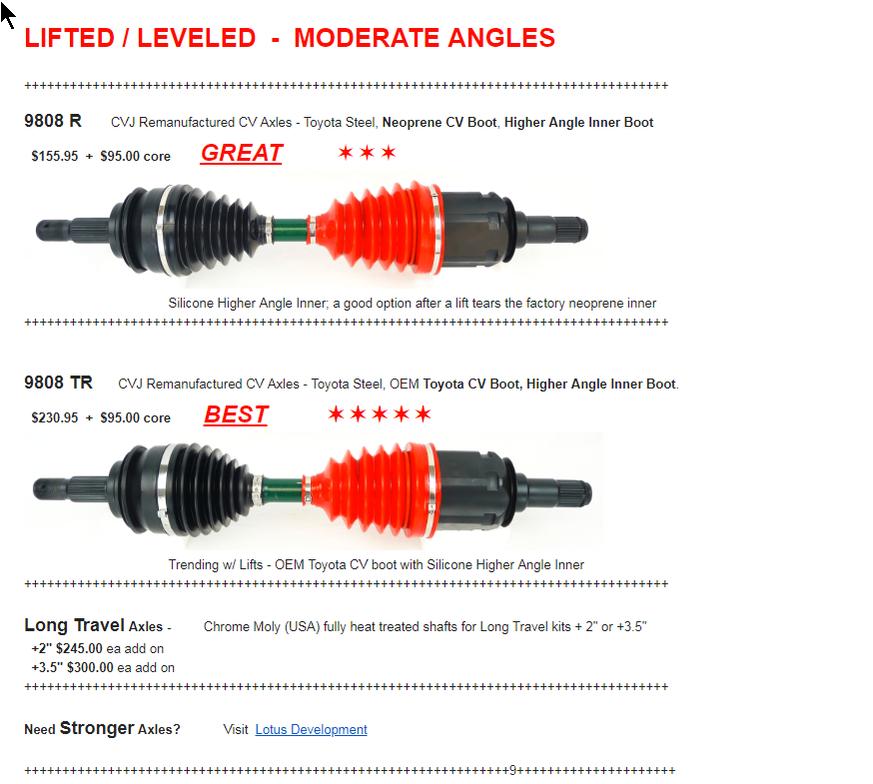

For what it's worth I recently contacted CVJ for a quote and the options for new cv's as the second set of boots have torn on my original OEM axles and at just about 145k I thought it might be time to move them to spares and get new rebuilt OEM.
I am still running the original OEM cv's that I rebooted with SDHQ boots 4 years ago. both sides have now cracked open on the inner boots. Considering conditions and use, I feel this is probably reasonable lifespan for reboots.
As others have stated, it appears we have an option for standard neoprene boots, (which is not as good as oem) upgraded inner red boots and upgraded to OEM toyota Hard plastic boots. Which if I understand correctly, is exactly what the trucks come with to begin with. Heres what they sent me.
I have not ordered yet, but I do plan to do the "best" one.

Looks like your sway-bar link boot has an issue too.
While that looks more like rubber rot/UV damage to me, on the CV.
Was thinking there was a "boot stretch mod", I read about here on the site.
Helps to reduce heat/friction of the boot ribs rubbing.
This PC I use will not work with the search function any more...thank you Google, or I would try and link some threads...
Yes, my sway bar end links need attention too. I've learned my lesson those in the past too, those are non-oem replaments that have lasted less than 3 years as well. I live in South Carolina, and the weather here is more harsh on things than other places. My OEM boots lasted 13 years, I expected the premium re-mans to last more than 2 years.
