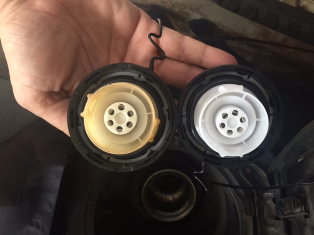

That is incorrect, you can get just the seal, and I just did this last month for my 4runner;
There were no CEL lights on, but I felt there were no resistance when I would remove the cap and since I have a long trip in plans at that point, I have replaced the seal, got is from my local Toyota dealer (around $8.00 including tax);
I don't think you need a new gas cap if it's not broken. I just replaced a gasket (77316-33042) on the cap which was much cheaper.
Agreed, you can get just the gasket from Toyota but if you have an auto parts store nearby you can just buy the entire new cap and pull the gasket off of it. They cost somewhere in the neighborhood of $13, and you get to feel smug about recycling the unused plastic cap when you are done.
