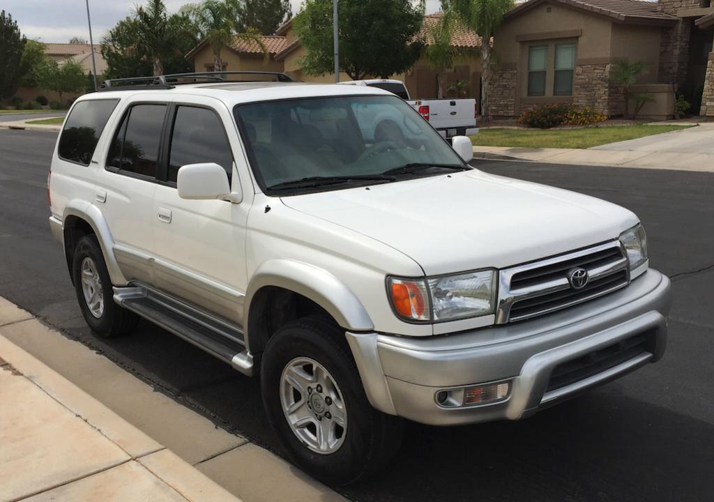

Day 3.

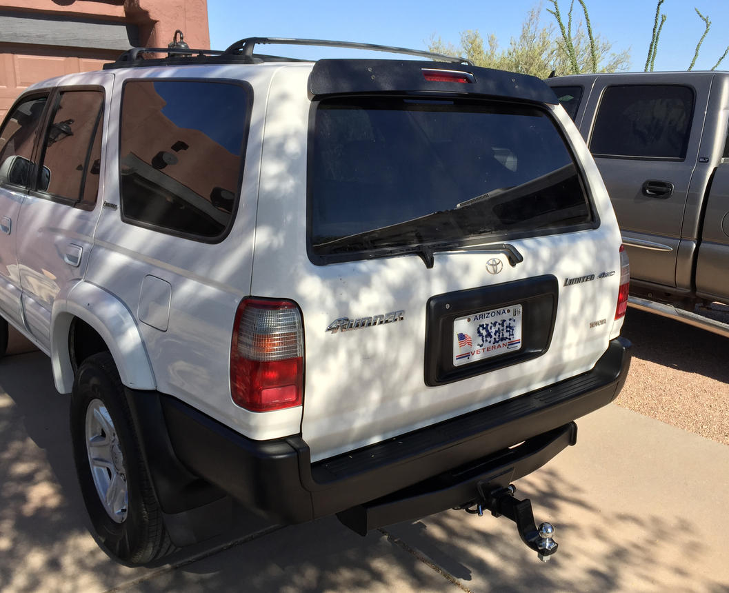

Painted the bumper, plate frame and wing.

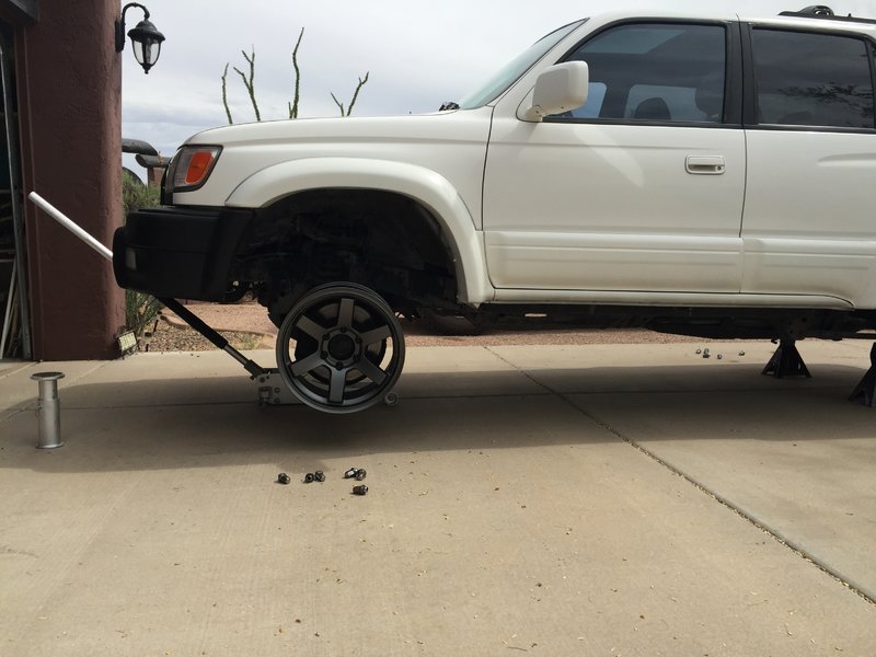

Day 5
Like a onion, found some bad old rotors and decided to redo the brakes while getting ready for install day!

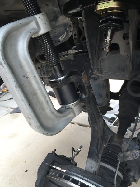

Removed the upper ball joint, what a ordeal but it will be worth it.
Pressing the ball joint out of the spindle is a HELLISH nightmare.
Should not be attempted by those with no imagination for creativity.
There really is no way to explain what I am talking about unless you do it and those that have probably know what I am talking about.
And most auto parts stores don't carry the right press to get them out.
You have been warned.

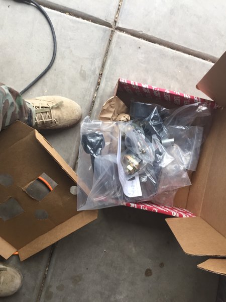

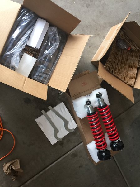

Toys from Toytec

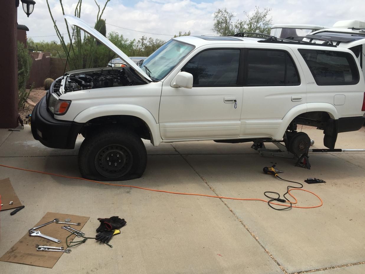

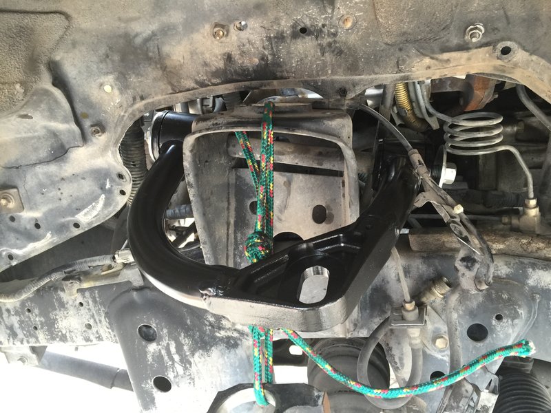

Day 6
The installation
June 11th 2015

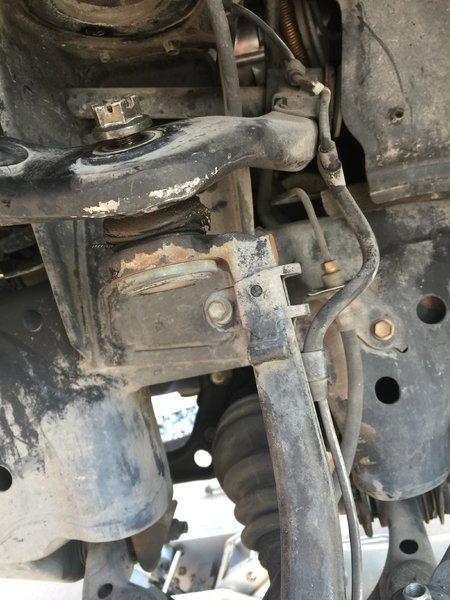

One side so far...
Now just button all the nuts bolts down...
I will add the notes later this evening when I am done.

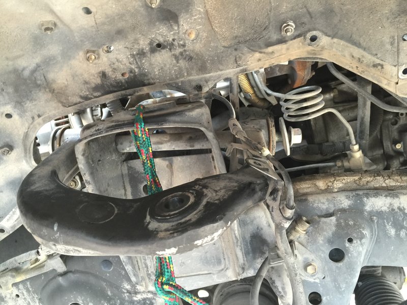

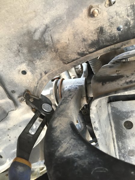

Old UCA
Had to bend out the fire wall just a tad. Pretty darn easy.
New Light Racing SPC Arm in...

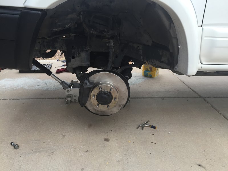

Pressing the receiver plate into the spindle. Alligator #2

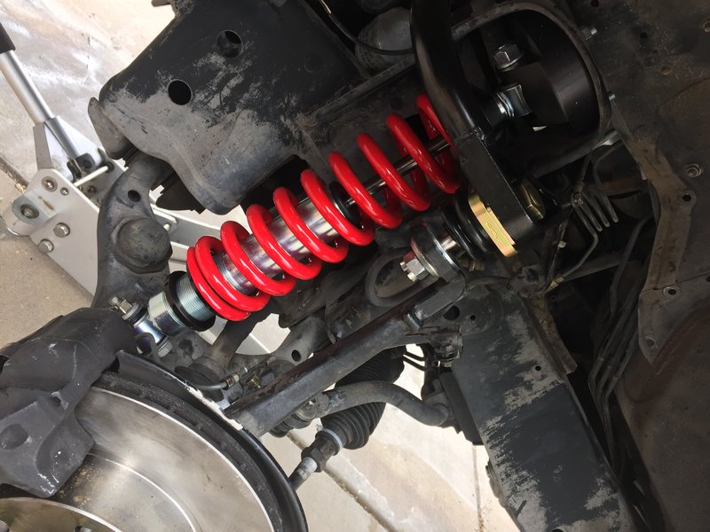

Coilovers, UCA in place. Just tighten down, Drive side done.
All and all, not too bad. Scale 1-10 about a 7, would have been a 4-5, if I had the right ball joint tool and press, but a little bit of spit and Enginuity and made it happen!

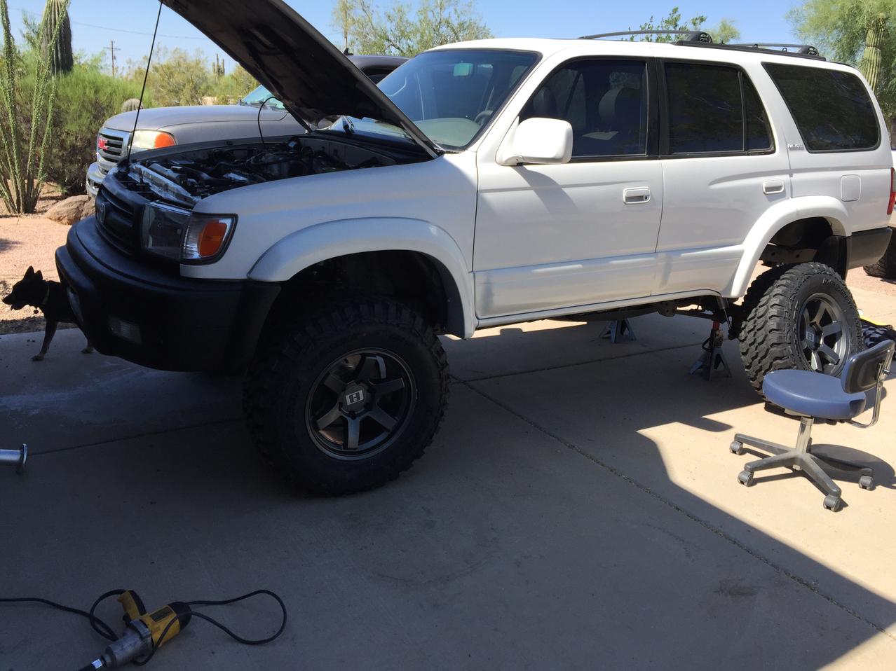

Day 7
Full Frontal Process. Let there be light, and he rested on the seventh for he saw what he had created was good!

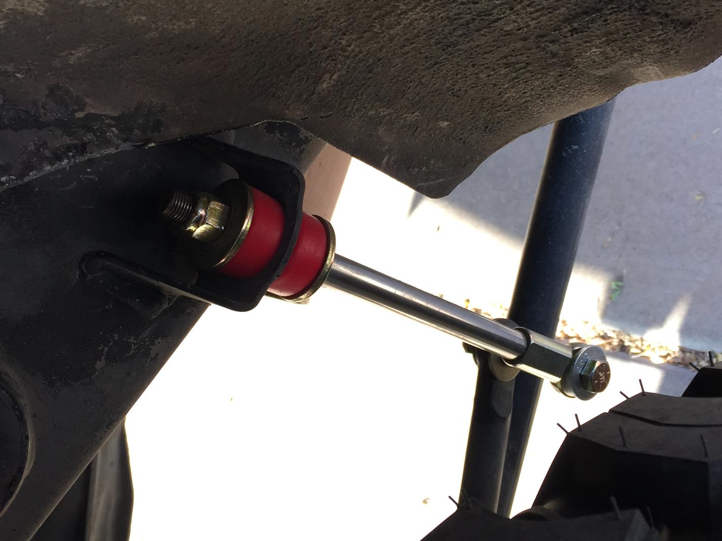

Hand Made sway bar connectors from an idea from a bud on another 4runners.com site.
I need more cowbell in the front.
Don't like the rake. Gonna kick up the Bosses!

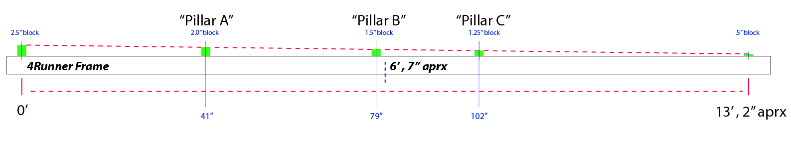

But I'm not done yet. Oh no!
I don't like the rake and I am getting a custom 2.5" progressive body lift.
Gonna make it all nice and purdy!

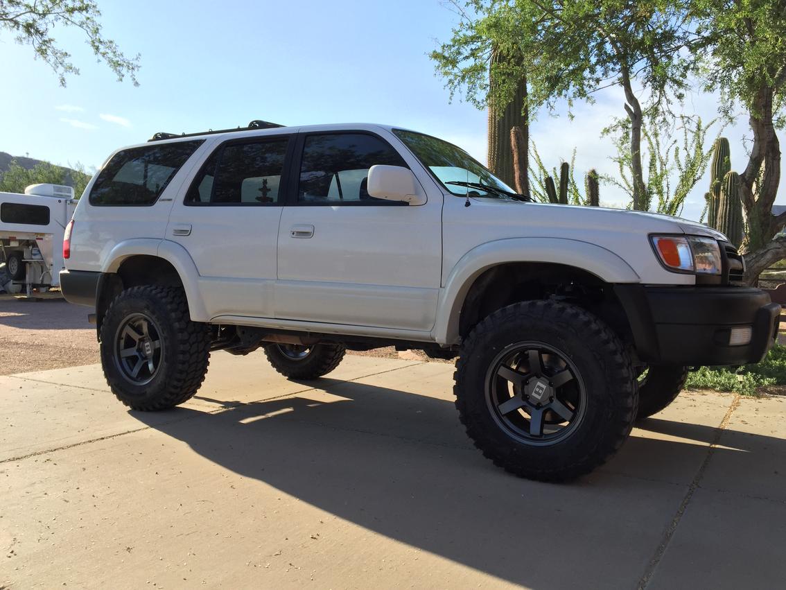

Day Whatever!
Almost done!
My progressive lift went without a hitch. I don't have the STUPID raking look.
Nice and balanced!
My Chi strong!
Got new CV axles yesterday and put them in.
Got her aligned this morning, drives great.

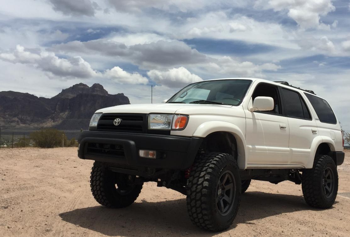

Gave her a bath and took a glamor shot!
Ladies, I give you, BAD INTENTIONS!

what size of tires and rims are you riding on?? How is the noise on those tires there, is it loud on the street??
Love the rig so far. Lift is clean and your progressive body lift removed rake well. As for painting, when you did the silver side trim white, did you rattle can and then clear coat? Looks almost factory!
Rattle can (spray can) factory color match with clear...
I may be going to black like I had on my Taco.
Thank you for your compliment.
285/70 R17s on LeveL 8 Mk6s -12 back spacing with 1.25" spacers
I am just getting the tires broken in, about as noisy as my Nitto Mud Grapplers.
But I think after a couple 1000s on them they will settle down.
Anything over 45 and they have a nice hummmm.
