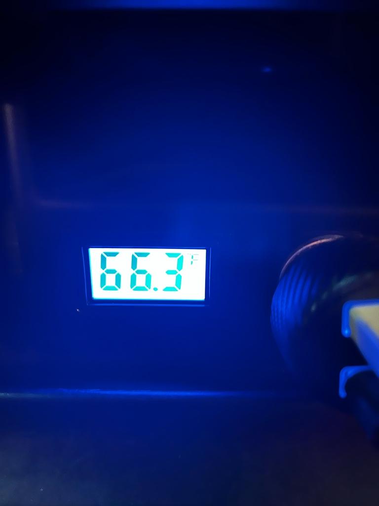

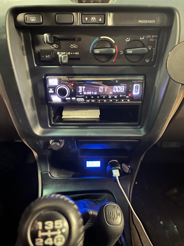

Also wired and installed an outside ambient temperature gauge. I dremeled and filed out one of the 12V outlets to fit the gauge. Took a little bit of time and was quite messy, but I’m pleased with the install results. I used the 12V outlet connector for power/ground for the display. I had to extend the temperature probe wiring which was a little tedious due to the very small wire gauge. Zip tied the temperature probe right behind the driver side of the grille to make sure I get good airflow while stationary. Display is a little bright at night. I haven’t had a chance to drive it during the daylight yet.

I ordered several, but ended up liking this one best: Mini F Digital LCD Thermometer Temperature Meter Gauge Sensor Indoor Outdoor US 708624426304 | eBay
I did have to extend the temperature probe wires quite a bit, but it still seems accurate to within a degree. It is rather bright at night so I might play around with tinting the display, or I might make a cover for night time driving when I find it bothering me. I'll attempt to upload a photo of it later today, but it might have to wait until Monday when I can use my work computer.

Here’s a couple pics of the display (hopefully). The photos make it seem about 50 percent brighter than what it really is.
I like that thermometer. I hope I can make something to make it fix by my rear view like the newer tacumas and 4 runners.
