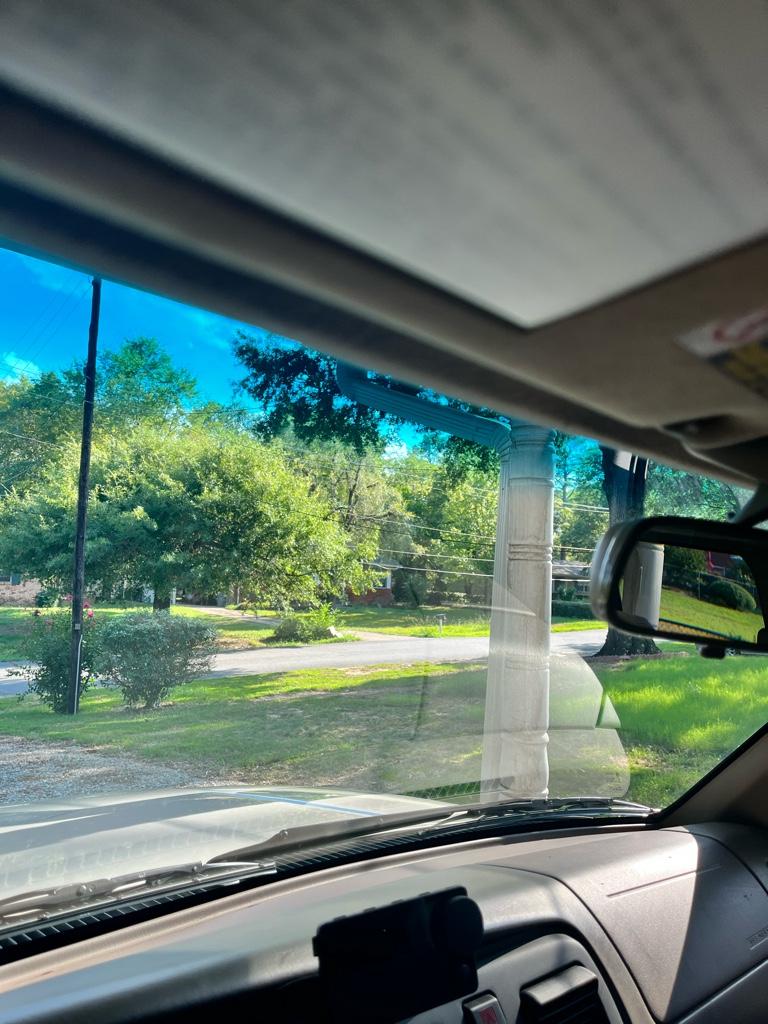

-Replaced windshield through Safelite. Green with blue tint. $385
I had a couple rock chips and an abundance of little sand chips in the windshield. After seeing [MENTION=118429]Sarki[/MENTION] replace his windshield I decided I deserved a new windshield lol I had Safelite come to me at work for the replacement. Of course the day that I scheduled decided to rain, but fortunately I was able to park in the shop in an empty bay for the guy to do the windshield replacement. There were a few rust spots under the windshield rubber molding, but he cleaned them up and put a rust converter then primer on the rust spots. Overall I'm very happy with the result. It's amazing driving with a brand new windshield! I ordered Cerakote Ceramics windshield treatment and trim treatment. They should be arriving today, but it's going to rain for the next week so I will have to wait to apply it. If you are on the fence about getting your windshield replaced DO IT! You won't regret it.
Have any pics to show? I’d like to get a new windshield since mine has a couple minor rock cracks from lots of highway driving. And also minor little specks that just won’t go away. But I can’t drop $385 right now for it if I don’t NEED it and it’s not obstructing my view. I’m curious to see how the tint turned out, too.
Try calling around to some local independent installers, I got mine done a year or so ago and it wasn’t even $200 and the guy does a really good job
You should contact your insurance carrier. I have Hagerty Insurance and they confirmed a glass claim will not affect my premium at renewal time so I decided to go that route instead of paying out of pocket.
Prices have gone up in the last year or so as I replaced the windshield on my 2000 4Runner about a year ago at the same Safelite facility I had the windshield in my 02 replaced and only paid $220 at that time.
They claimed the increase was due to “supply chain issues”……very convenient!
Mine was more expensive because I had them come to me ($50) and paid extra to be the first one that morning ($15). But I did get $50 off by starting to make an appointment but not finishing it. They emailed me a discount code the next day which obviously worked lol
