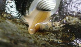

Pull your dipstick and oil fill cap and check the condition of the oil. If it looks like chocolate milkshake (or coffee with tons of cream), then you have coolant in your oil.
That's a good photo of the coolant oil mix..... Looks nasty.
