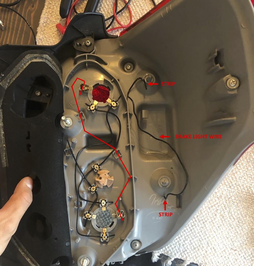

Stripped brake light wire for fix
I had to take out my left brake tail lamp. I found out that the brake light is powered by the wire I outlined in the pic. I stripped the ends with a wire stripper and re-clamped them down.
Just sanding and cleaning the connections didn't work for me.
