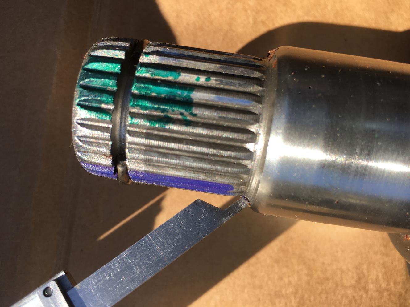

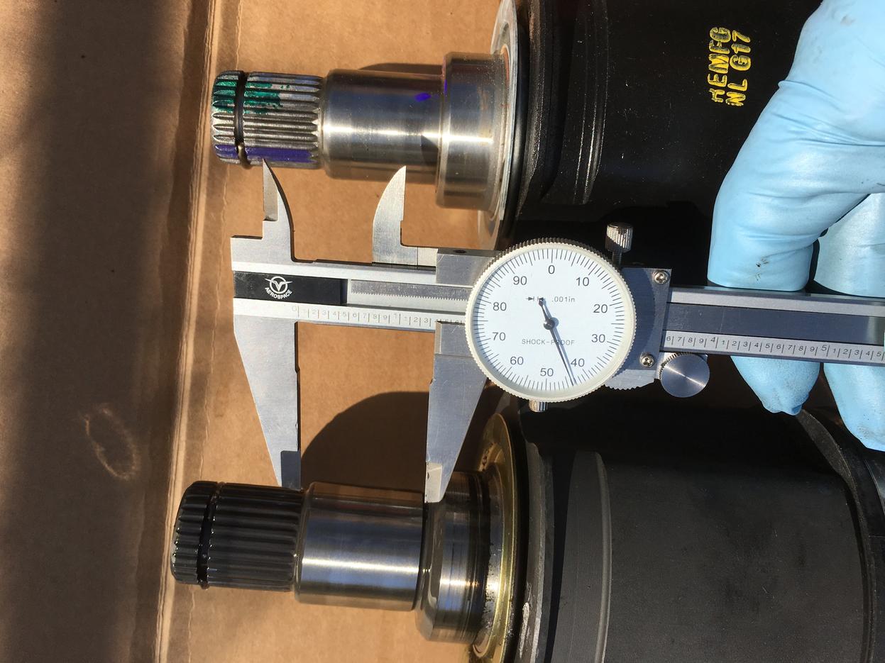

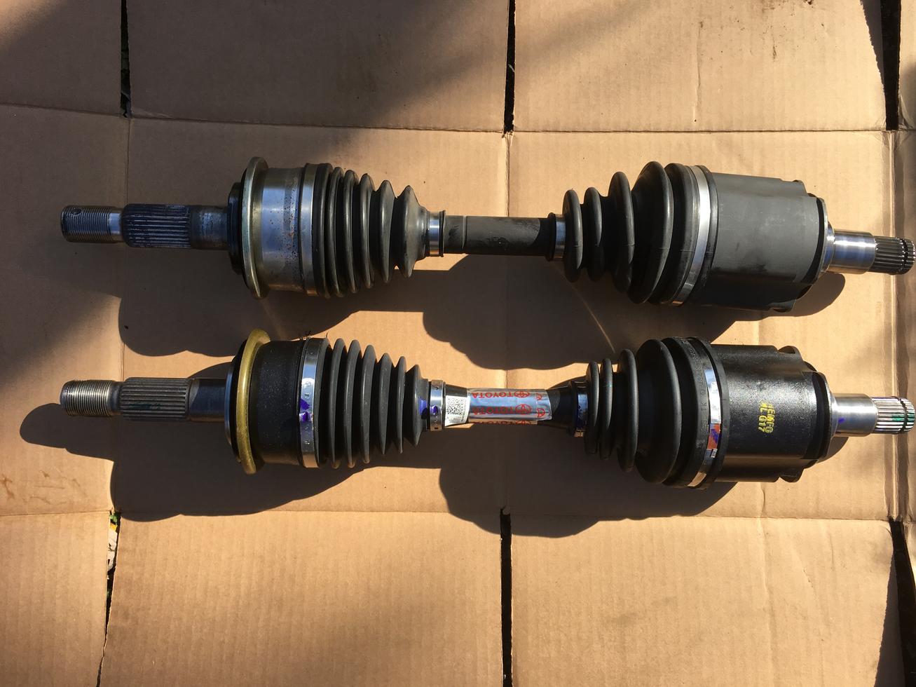

Here are some pics of the NAPA vs OEM axles. Thinking back, the NAPA axles probably didn't cause any vibration, although they probably won't last as long as OEMs. They weren't any cheaper than the OEMs either...
Really the biggest difference I saw was the stub shaft profile. The Toyota CVs had full diameter and fillets the whole length, while the NAPA CVs had relief cuts and sharper edges. I doubt it's something that would cause either one of us issues on 32s but those that are running 35s or 37s especially ought to give it some thought. That would be a crappy place to break a CV.
