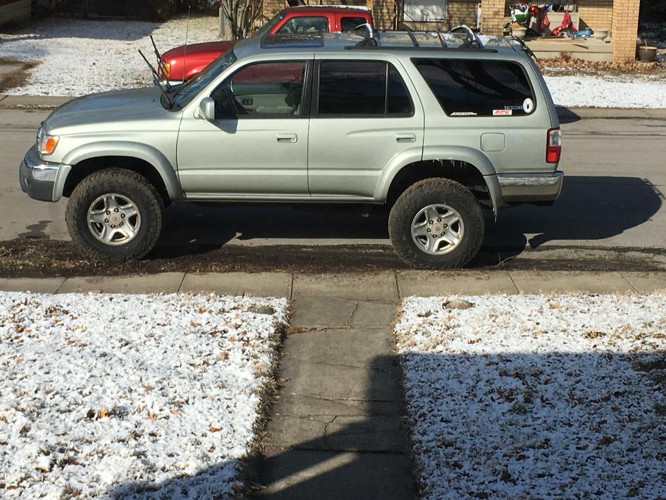

Further, I wouldn't be so sure that you have 2.75" of lift. Are you armored in any way or do you have stock bumpers? Look up stock ride height from hub to fender and then measure what yours is. That will give you a pretty good idea as to how much lift you've actually got on the front end.
Let's pontificate for a minute, because there's snow on the ground and the windchill is 5 degrees. I have zero desire to turn wrenches in that nonsense.
I'll edit this post in a minute with a pic from today.
Yes, it has OEM reman CVs in it, hub to fender at the front is 22-3/4". I'll SAS it before I take more lift out of it at this point, because the whole point of all this time, effort, and money has been to have a lifted 4Runner.

My passenger CV has just a little bit of play like you showed in the video of your driver, but not as much for sure.
