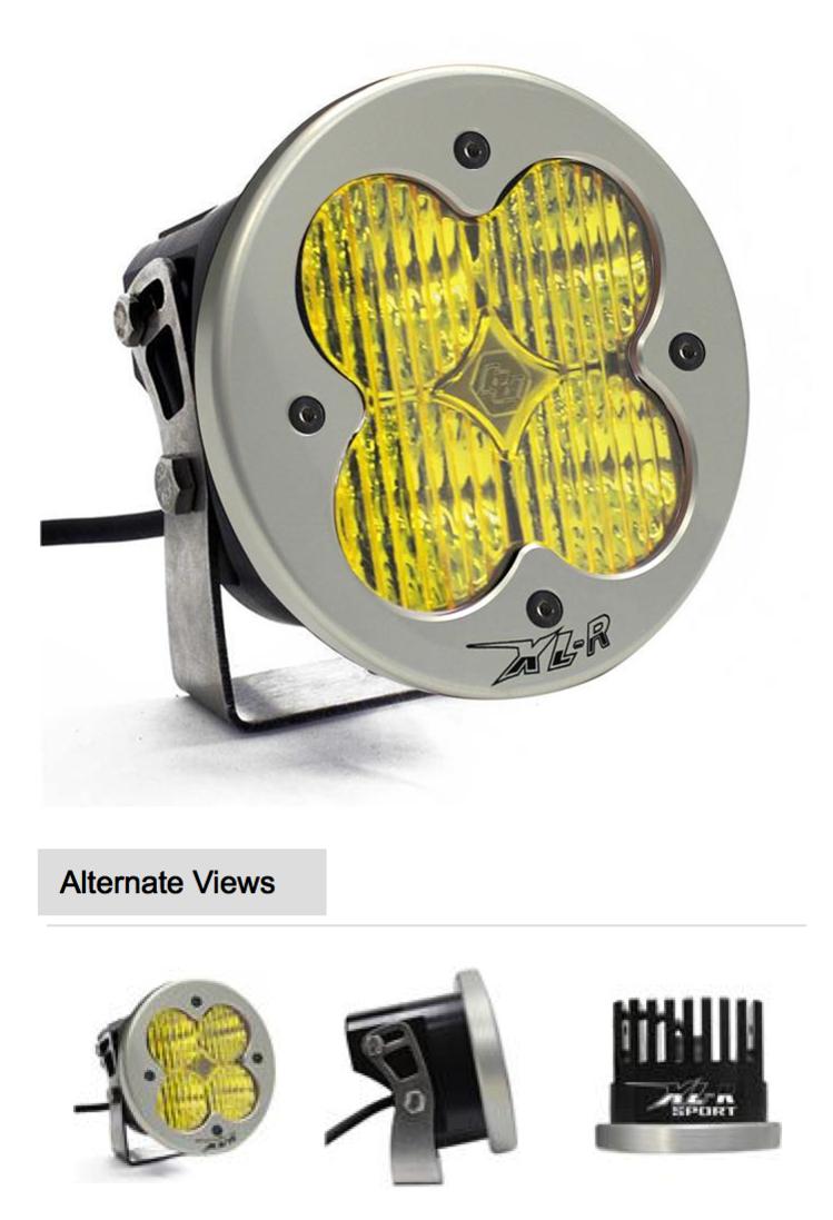

This has me wondering too, the Amber wide cornering XL-R sport lights look nice.
