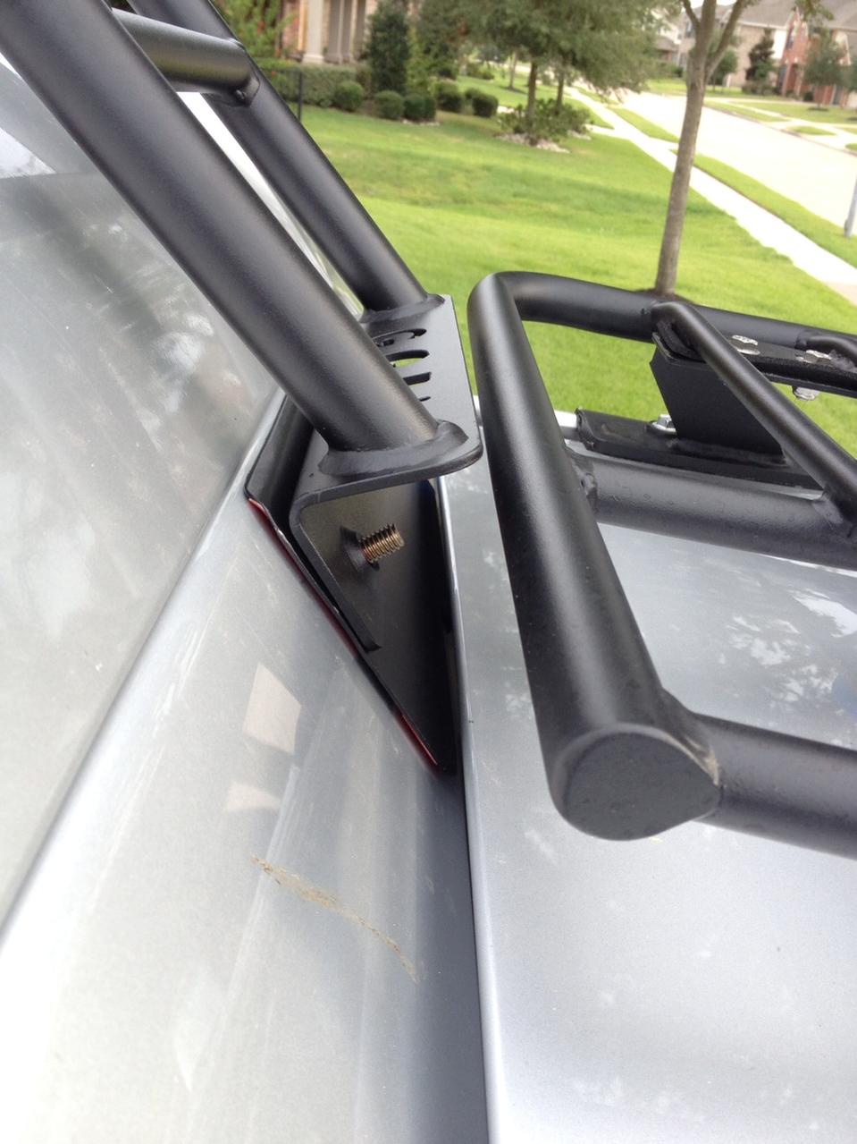

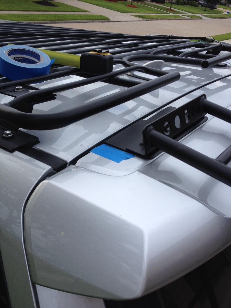

Hi Guys, my Gobi ladder finally came in and thought it would fit with my Baja rack seeing some of the other guys here have done it. The top of the ladder, where is says 'GOBI' comes into direct contact with the back bar of the Baja at only half open. Any suggestions?

Ran into that myself, so I grabbed my angle grinder and took off enough to allow the ladder to clear the rack. It still barely rubs on occasion. Repainted, then put additional black tape at the rub location on the Bajarack. Don't know if you can clearly see in the attached pic.

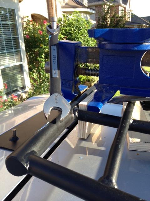

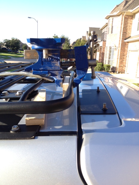

I'm getting deeper and deeper into this problem. I think the only option is cutting this portion of the rack out. I'm hoping it will not completely weaken the structure.
The "crushing with a vice" -mod, lol... is futile

No, it's not clearing now, or will it ever doing the math. I have deduced my rack must sit further back than yours and the others, because the hitting starts when the hatch is not even halfway open.

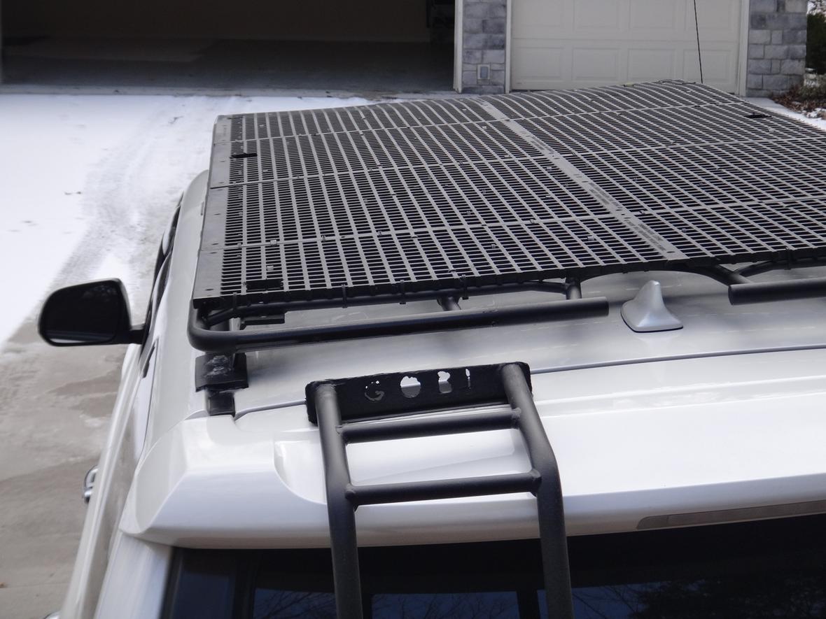

For reference, here is my Baja Flat Utility Rack mounted with Gobi Ladder.
Both purchased and installed in 2015. As mentioned in my previous post, I believe one of the vendors addressed the clearance issue.
Mine clears perfectly with no modification and no rubbing.
Hope this helps with anyone making this decision currently.
