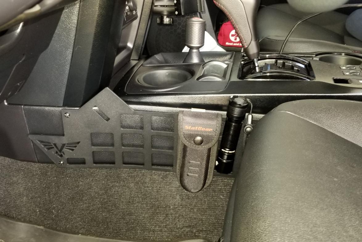

Got one in. Couple of things to note.
-I had to use a make shift brake and put two small bends in the panel IOT fit the contour of the center console better. I"m guess this is why there are no pics from top down.
- i took the console apart, used nuts and washers to secure it. This required drilling out the mounting holes and was a small PITA.
- not all U.S. G.I. molle attachments are compatible. Mostly the plastic parts that are designed for the webbing of the LBE and not 1/8" thick metal. Kind of a let down as there are tons of kewl guy attachments out there and in the bottom of many of my tuff boxes. You can weave the USGI webbing into the panel, but the non milspec makes it difficult to get them tight. Kit/pouches with the old ALICE clips would be a better fit. Belt clips of course work fine.
All in all, not a terrible mod and should be very versatile going forward.
One last note. If you plan to use the nut/bolt attachment idea. Slide the panel back toward the seat about a 1/4". This will avoid the molded plastic support structure molded into the center console.
Just my .02
