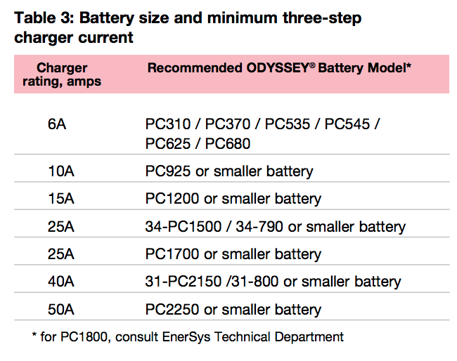

I'd recommend a higher amp charger. Per Odyssey's technical guide for the group 31 battery they recommend a 40A charger for this application. They recommend this due to the group 31's high capacity and need for higher current during the bulk charging phase to un sulphate the battery which is where the majority of the charge happens.
With the NOCO you're only giving 18% of the recommended amps.
Also you do need a VB. The moment you crank your engine and leave for your trip you've discharged the battery and will never get it back to 100%. Odyssey recommends the alternator put out 14.0 to 14.7 volts which the stock alternator does not deliver without a booster. In the end it's your rig and investment but there's some misinformation here.
http://www.odysseybattery.com/documents/US-ODY-TM.pdf
http://www.odysseybattery.com/documents/US-ODY-WS-AA.pdf

It’s fine… Those recommendations around battery sulfation have more to do with a deep discharge condition over extended periods of time, or when the load is larger than the charge coming in. For most people, the bulk charging phase is going to be taken care of by the alternator… These chargers are really just to maintain the battery. Most of the time its going to be near full charge anyway as we run the truck regularly.
These guidelines are also the manufacture trying to manage expectations for people who don’t really understand batteries. You get someone buying a 0.75A charger expecting results, and in reality it will get it charged, but it’s going to take days. Less calls into support for people who degrade their batteries using them incorrectly.
If you ever monitor the current when the ACR pairs a partially charged battery in parallel with the starter, you will see a peak, bulk charge from alternator, and then will quickly taper off into the single digits while it equalizes. It’s not going to slam in more current than the battery can accept. If it does, it’s using a voltage higher than acceptable.
I’ve tested, monitored, and observed this on multiple occasions across different systems I have built.
