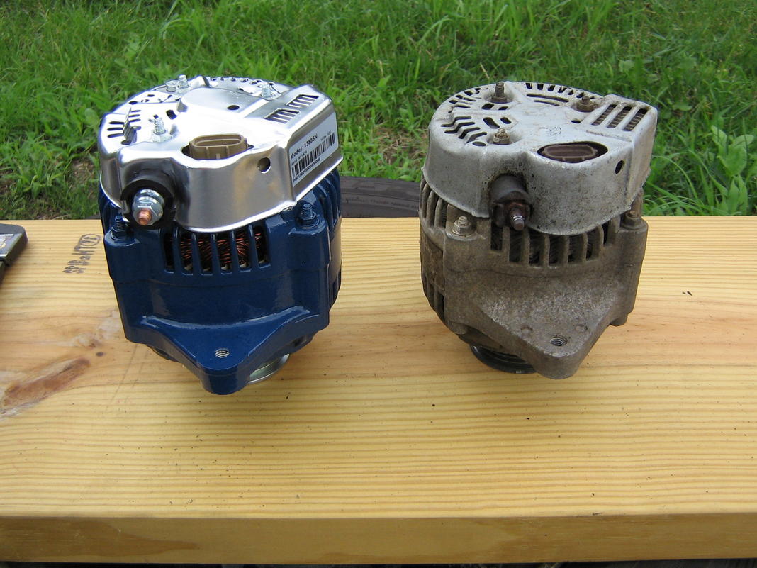

Old vs new
AC85BC74-CB34-4714-9EC6-30C968091ECF_zps5pijt1yv.jpg~original
Pretty sure it is the alternator brushes. It is super easy to replace and cost few $$$. It is worth trying. Corolla, camry brushes are also the same!

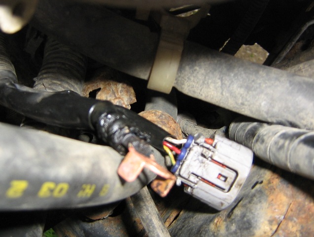

When removing my old Alt I noticed the the ground wire was very hot with melted insulation around the connector.
(I had to move my truck from 1 part of the yard to another) I haven't driven it in almost 3 weeks.
Also the plastic around the ground connector on the Alt was melted. See comparison below.
Was this caused by the faulty Alt?
Looks like it could have been a potential fire.
Could it have been the massive corrosion on both connectors restricting the current?
I wire brushed the spade connector on the ground wire before installing the new Alt.
When I installed the new Alt the ground wire didn't get that hot.
I always have a fire extinguisher in the truck but I'm glad I haven't been driving it being afraid to get stuck somewhere.
I did a lot local test driving yesterday & no electrical or burning smells coming from the new Alt or wires.
