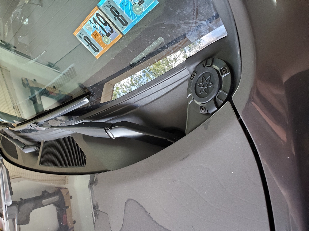

Might be overkill for you but i have the noco 4amp installed on the passenger side and mounted a plug on the drivers.
You could easily add a sae style connecter to the battery (make sure its fused) and zip tie it near the grill.
Sent from my SM-G973U using Tapatalk
Oh i realized i missed the point.
I have wired in the permanent connection to the battery. As the deltran, it has a cap for when not in use.
As for a hook up, i connect it and lay the wire across the giant TV table tray by the hood catch. I put the ctek unit on the side of the washer fluid fill, opposite the battery. This keeps everything away from moving parts.
I then route the power cablenout the front in the little pocket between the headlight unit and the corner of the grill and hood. There is a little squeeze but there is no concern of the cord being severed
