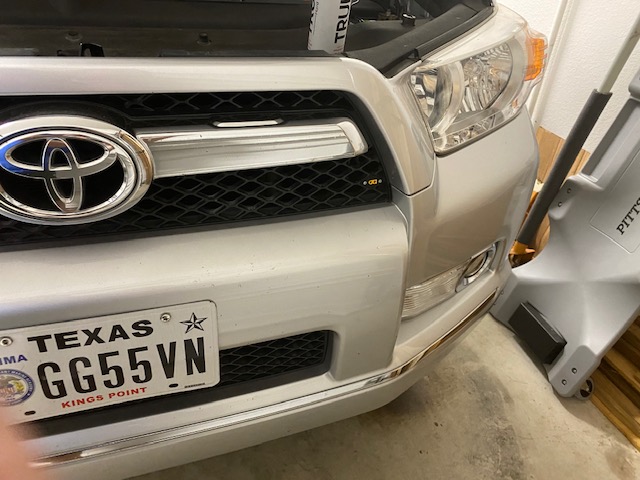

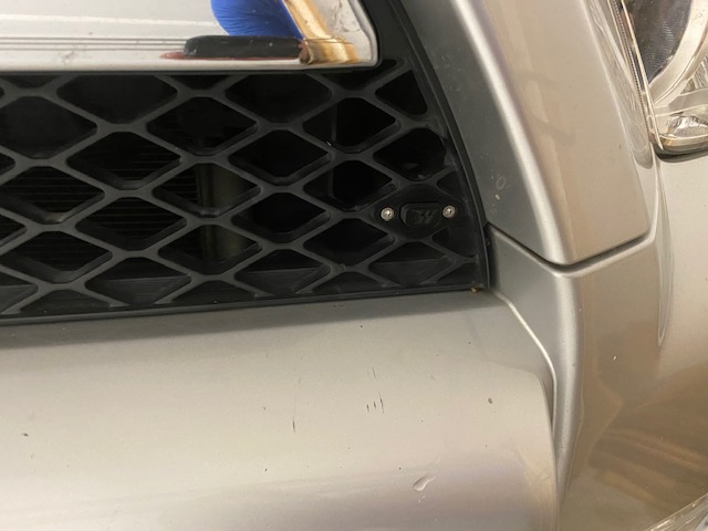

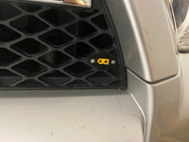

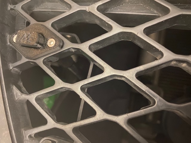

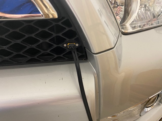

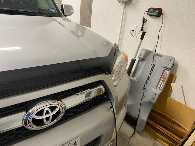

Finally got around to completing this little project. I've been popping the hood and using the Battery Tender's battery clamps but I really wanted to do something more streamlined. I designed and 3D printed a fitting for an XT60 plug that would fit in one of the grille diamonds of my 4Runner. Since the wire is an adequate gauge, the connector also doubles as a power point for my little Viair compressor.
