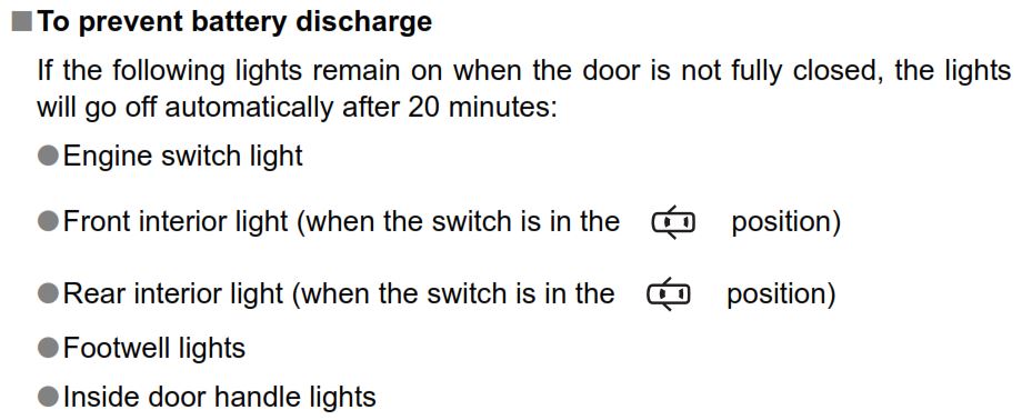

It suppose to automatically shut off the lights after a certain time, so the battery not get drained.
This is not entirely true. You can find a number of instances on here where interior lights have run the battery down if the lights are set in the "on" position. I think in my case, the kids jumped in the back storage area and turned on the hatch lights. Excerpt from owners manual on the feature you're referring to:
