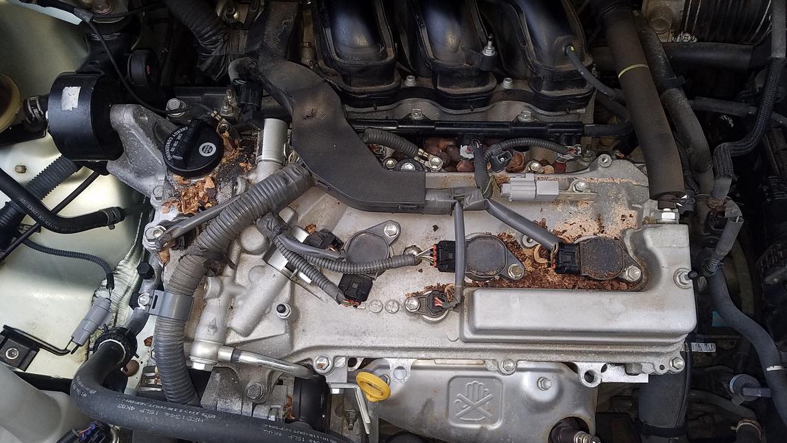

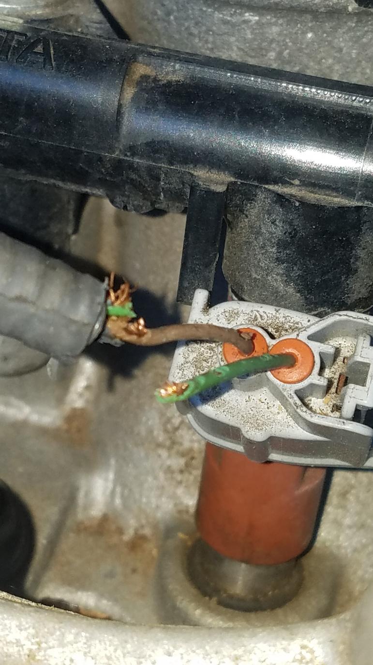

So I live out in the country and love every minute of it. However, this year, the squirrels and the mice have been wreaking havoc on our vehicles. (See attached photos). Turned wrenches on a Sienna throwing all kinds of codes until I found where a squirrel had chewed through one of the wires to the fuel injector. On another vehicle, they chewed through the vacuum lines and it was a PITA to fix. Lived in the country for along time and never had this issue before!
They have not touched my T4R...guess it is the LiquiMoly......(Beat you to it LittleCaeser)
If anyone has this problem (or has had) what have you done about it? Put mice bait on or around the vehicle?
