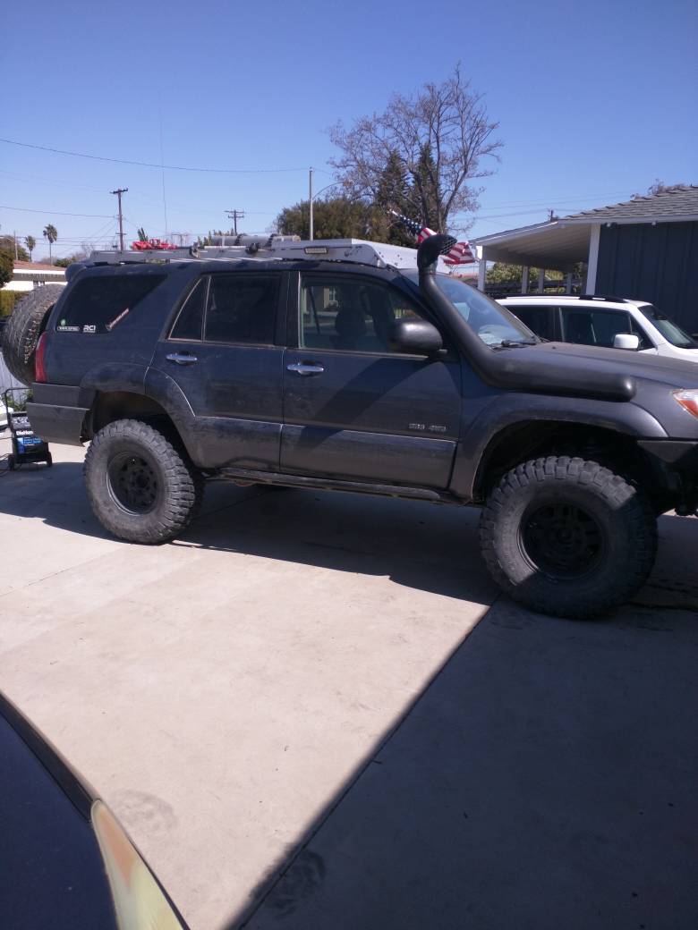

This is the most recent pic.

Damn looks great! I wish the sliders I got angled up more.
It looks like you had to trim the rear custom bumper where it meets the wheel well? It's hard to tell.
And you have a snorkel, which one did you use? Is it spec'd for a Taco? And what wheels are do you have there? Are they steel or Alloy?
Rear bumper hasn't been trimmed yet. If I move my axle back I might have to. Not sure yet. Centerline wheels. I believe alloy. They came with the 35s as a package deal. Ill probably go SCS SR8 eventually. Sliders are RCI bolt on. I actually need to fix those some day too because my doors scrape them on top. They're angled wrong for a bolt on. Snorkel is the lc80 eBay snorkel.
