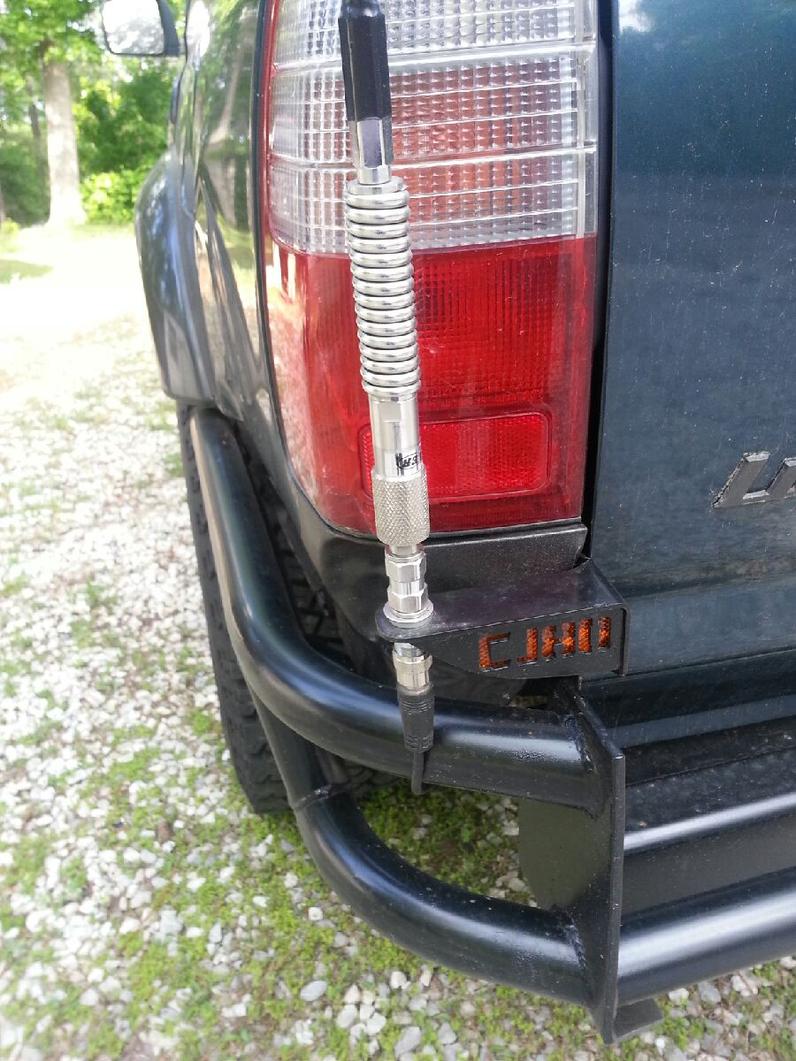

I have a good sized dent on my driverside rear and bare metal was exposed in a few places. I used the rustoleum rattle can bedlliner on my truck a few years ago and then hit it with some charcoal metallic rustoleum a couple minutes later. It still looks pretty much like the day I did it.
This isn't the best pic because I was actually taking a pic of the antenna and parts I'm selling in the classifieds.
