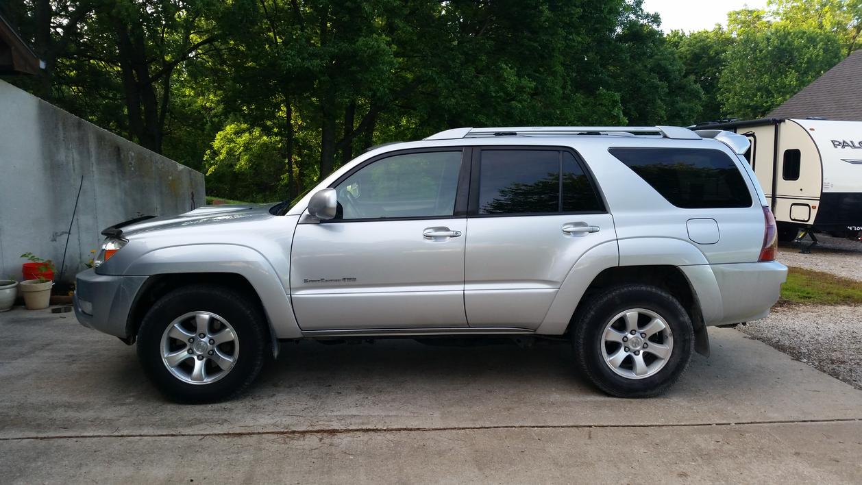

Heres a poser shot of the new ride.

congrats on the T4r- 83k is just breaking these in!

And nice 4runner, have the exact same model and year, color too!

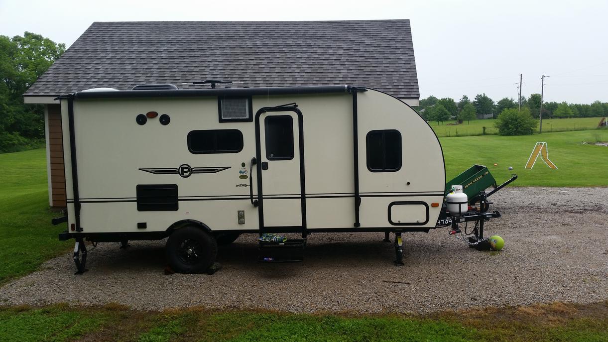

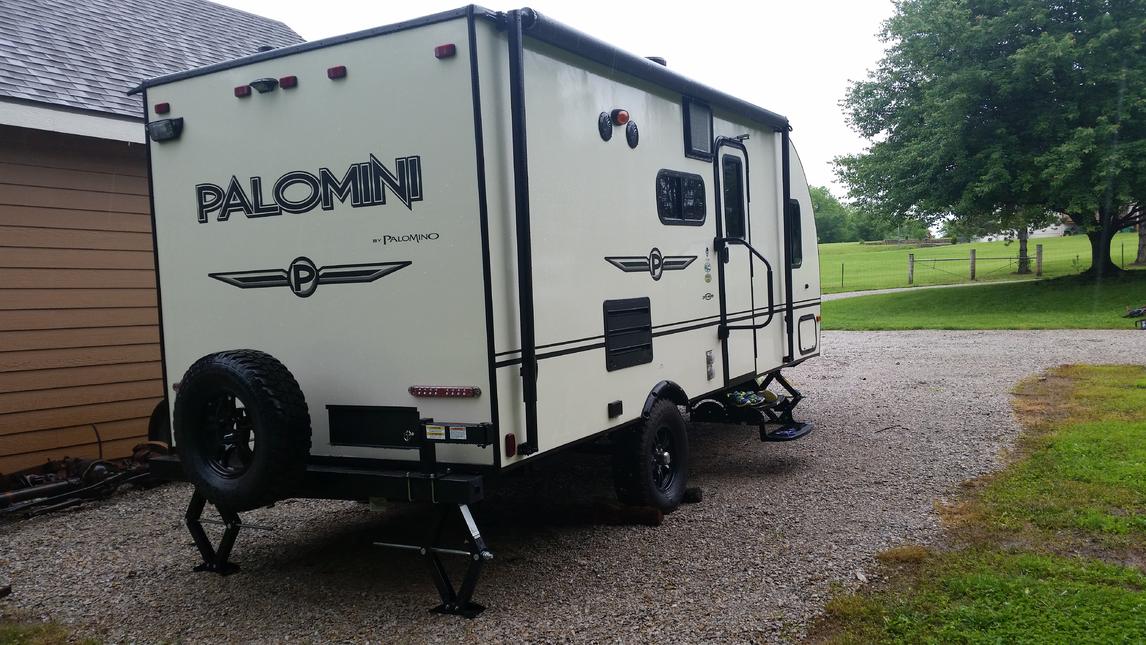

The camper is light weight travel trailer with a small factory lift and 29" inch mud tires. Its not designed for difficult trails but it will go down low maintenance and logging roads to get the family away from the crowd and not be in a tent.
Heres a couple photos.

thats a cool camper you got- im thinking to get a 13ft scamp to do kinda the same thing plus fishing trip on the coast

very nice! extra cool it came lifted-!do you feel it being top heavy on the road..maybe in the wind??
Well to be honest we towed it home from the dealer with my wifes 06 Sequoia and it pulled fine. I know what your saying though as we will be towing it across KS with a 40 mph south breeze. I installed a weight distribution hitch with anti sway control. I think it will fine, the A/C is on the side instead of up top to help with the height and clearance. We shall see!
I haven't had any top heavy issues with my Scamp. They're so light that I'm sure it's better than other trailers for that.
