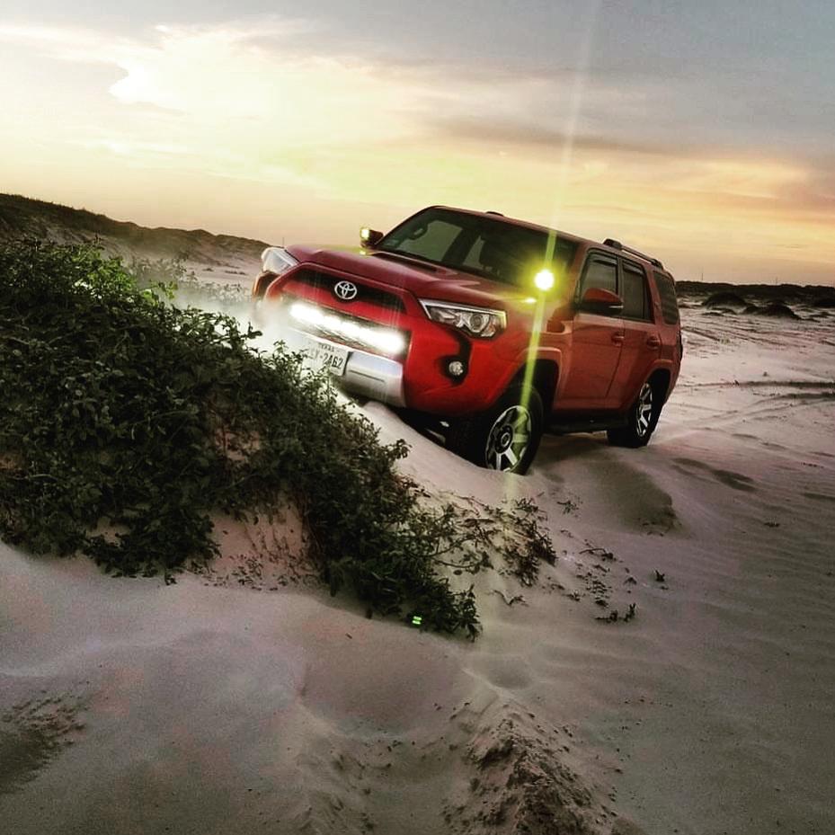

How's it going. I'm running the Hidden Bumper Brackets and led bar from [MENTION=139789]RagoFabrication[/MENTION]. Very solid kit and does come with everything needed to install. Install isn't very difficult but you may need help removing the bumper. As always the Rago's will tell you to watch the install videos on their website and ask any questions you have. If all else fails they have their direct number to call and get help over the phone.

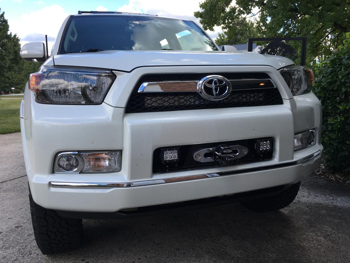

I've eyeballed a 2014+ and believe it would work similar to my 2013. I mounted to the upper bumper support. No brackets needed other than what it comes with. I have the 28" version:
