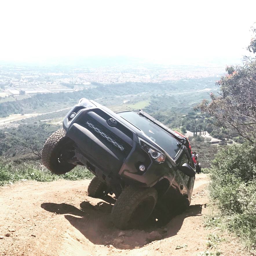

i run these on my 4R. Only modification i had to do was trim some plastic for my 32" bar. I could've saved like $40 by going to Lowes and fabricating my own, but for the time, effort, and paint, i just went with a pair Ragofab spent the time to design, fab, and paint. Haven't had a single problem since i got them over a year ago.
