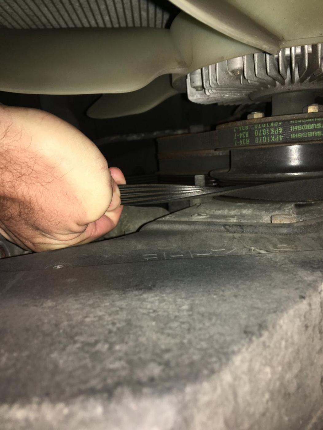

Thanks. Took this last night. Will check deflection today. Didn’t have time.

So too loose?

So too loose?
Yea, for sure. Can easily twist 90 degrees. Haven't had to time to tighten it yet, but will report back. It only does it if the truck sits overnight or there is moisture.
