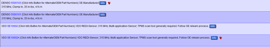

The wife's 2005 Limited lit up the low tire warning today. All tire pressures checked good. Hooked up TechStream and have a DTC C2121 active code for (ID1 Not receiving data from transmitter). Being that the sensors are 12 years old, I plan on just going ahead and changing all five of them. What is a good brand/source to look for and what can I expect to pay for all five? Bypassing the system is NOT an option as she want it to TPMS system to function correctly.

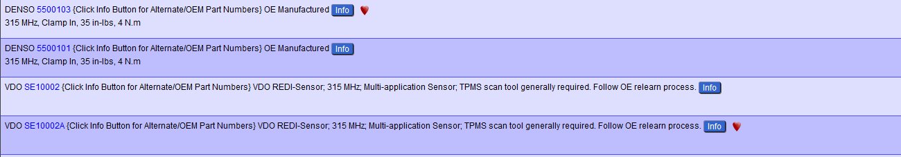

A search of RockAuto listing show two applications each for the Denso and VDO. Both list the OEM part number. How do I know which one to choose...

I was wondering the same thing, but what I can tell you is the item with the "Heart" is the one most people purchase, so I would think it would be the one to buy, that being said I would think both would work as Rock Auto wouldn't be listing it if it will not work with your vehicle.
Not sure if this will help but they do have a phone number and email address, you can try and contact them to see if they can clarifiy which one will work.
