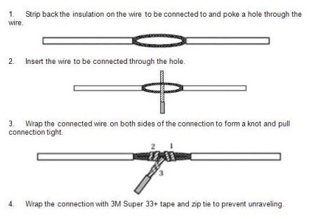

You do not want crimp connect alarm wire, most connections are tapping into OEM wiring so you certainly don't want to cut the wire in half and then make you connection. Strip back the OEM wire, poke a hole in the center then wrap, also known as a military splice is perfectly acceptable. Soldering after that connection is even better.

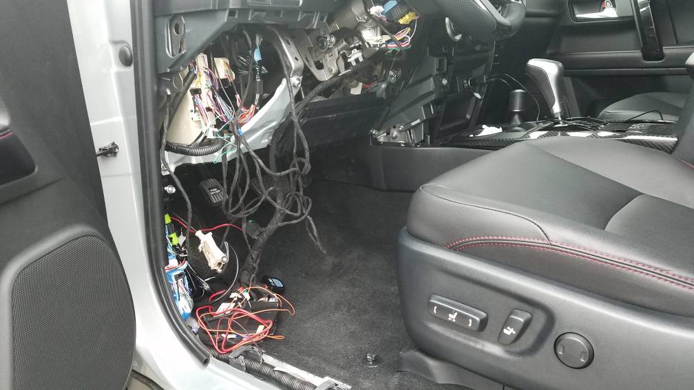

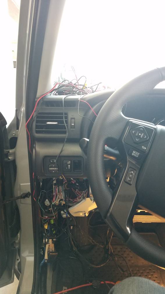

[MENTION=136181]Drebels[/MENTION] did his install. There were complications and i we were able to work thru them. He was my eyes and ears from 3000 miles away. together we were able to get his install straight. He also soldered all his connections and i verified them thru photos and videos.
