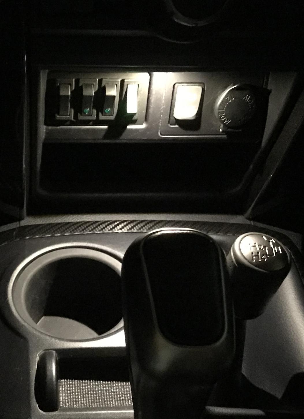

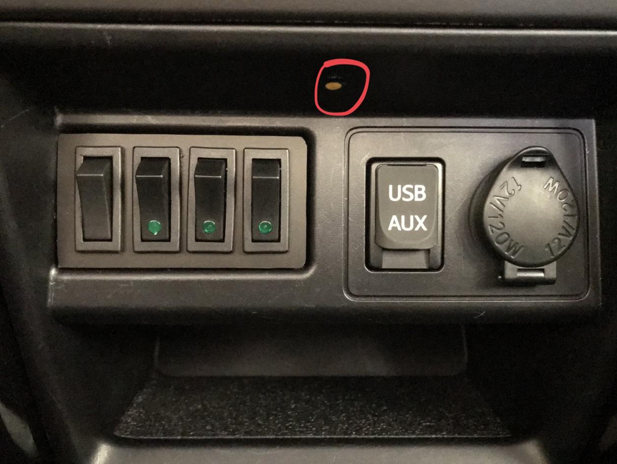

Ever since I got my 2018 ORP I’ve been perplexed and annoyed with the small rectangular cubbyhole under the AC controls. It’s kind of useless; nothing fits there, except for a tin of Altoids or Skoal, I suppose. After reading this thread I got the idea to install a four-switch bank to control interior lighting and other low current devices. I used one switch to control an LED to light the cupholder/shift knob area. Another switch will be used to switch the power outlets with constant 12 volts or accessory 12 volts. The other two switches will be spares for future use.
Parts:
- 4 position S-Tech switch housing called the “Toyota 4 Runner 14-18 * 4 Position”, qty 1
- RB141C1100-234 Switch, OFF-ON green illum, from Digi-Key qty 3
- RB145E1100 Switch, ON-OFF-ON, from Digi-Key qty 1
- 6mm bolt LED from Oznium in warm white, and a 6 mm drill bit
- Insulated Male Female Disconnects 0.25 inch tabs
- Wire taps 14-18 AWG
- Wire, black and red 16 guage
It looks good and works well. There were a few issues with the S-Tech instructions but I got through them with help from forum postings and being careful. If anyone is interested I can elaborate further.
