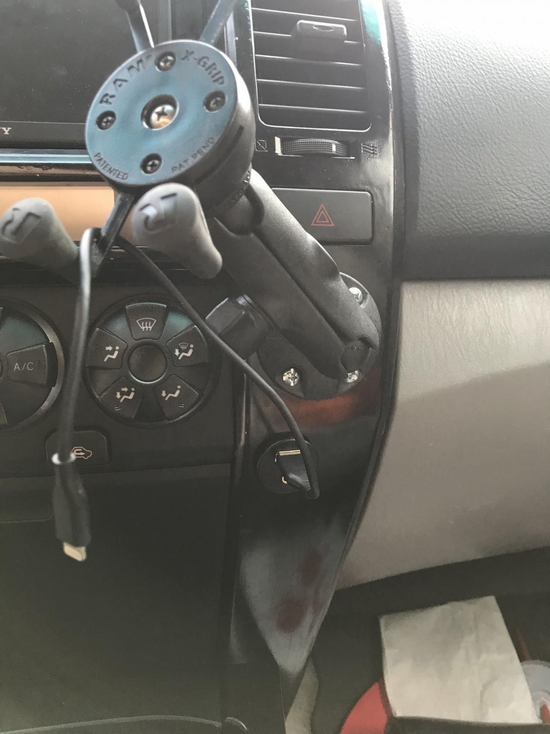

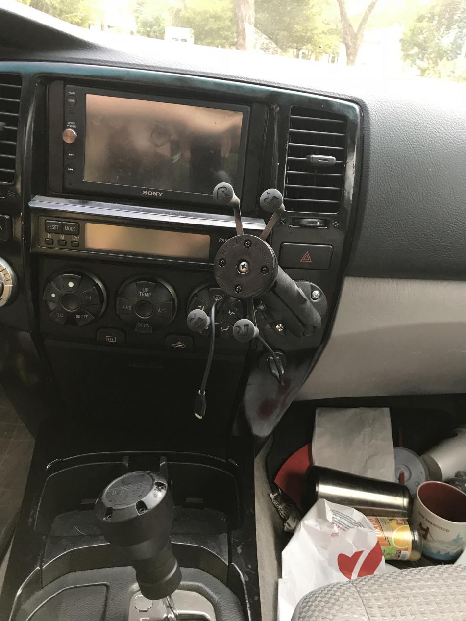

I did exactly what you're thinking of. Only difference is that I have steering wheel controls. However, due to a previous owner doing a hack job on a previous headunit install, and cutting some of the stock wiring harness, my steering wheel controls don't work.
I installed the same headunit, primarily because I wanted carplay. Its a simple, great headunit. I've been happy.
I had the USB wire running to the center console for a long time, before I finally routed a permanent USB port directly under my permanently installed Ram mount. I like my ending solution better than the routed USB wire, but if you're concerned about drilling holes, any of the options you mentioned would work well.
link for the USB port:
https://www.amazon.com/gp/product/B072KGMJ5N/ref=oh_aui_search_detailpage?ie=UTF8&psc=1
And some bad pics of my final install attached below.
