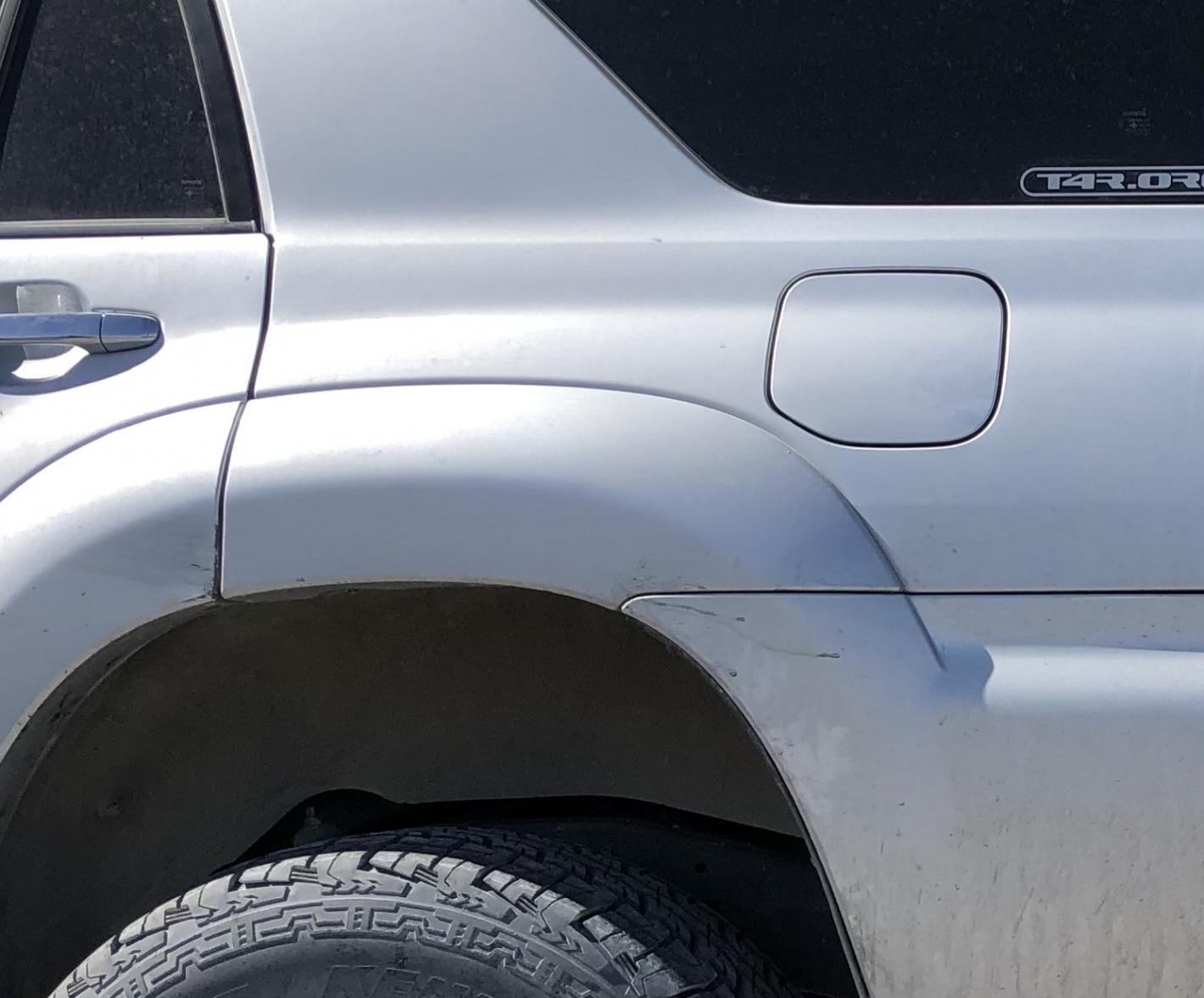

I used 5 minute epoxy to glue the rear quarter panel piece to the tabs that bolt/clip onto the body after my wife hit a Juniper when out wheeling two years ago and it’s still holding strong.
