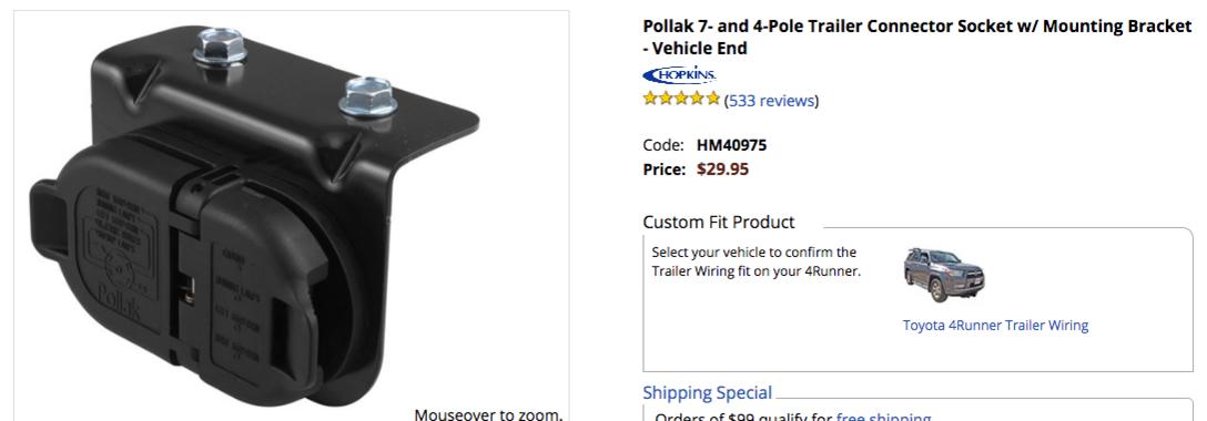

If you plan on maybe trailer brakes in the future, why not just go up to a 7 pin as most electric brake trailers usually run off of them.
And since your going to have to design a switched lighting for your setup.
True, and 7 pin connectors allow for larger wire in the charge line. They're also more common - 5 pin connectors are oddballs.
For the reverse lights the easiest thing to do is use a double-throw switch. When you throw the switch one way it connects the battery line to the reverse lights and disconnects the reverse line from the truck. Throw it the other way and it does the reverse.
That's what I did with my FJ Cruiser. I used a step bit to drill the hole for a 7-pin connector socket and then drilled and tapped 4 holes for the screws. This was into a metal All Pro bumper. Was easy to do and I like the clean look of it. The only thing to be careful of is that the hole you drill matches up with the existing holes in the bumper crossframe.
