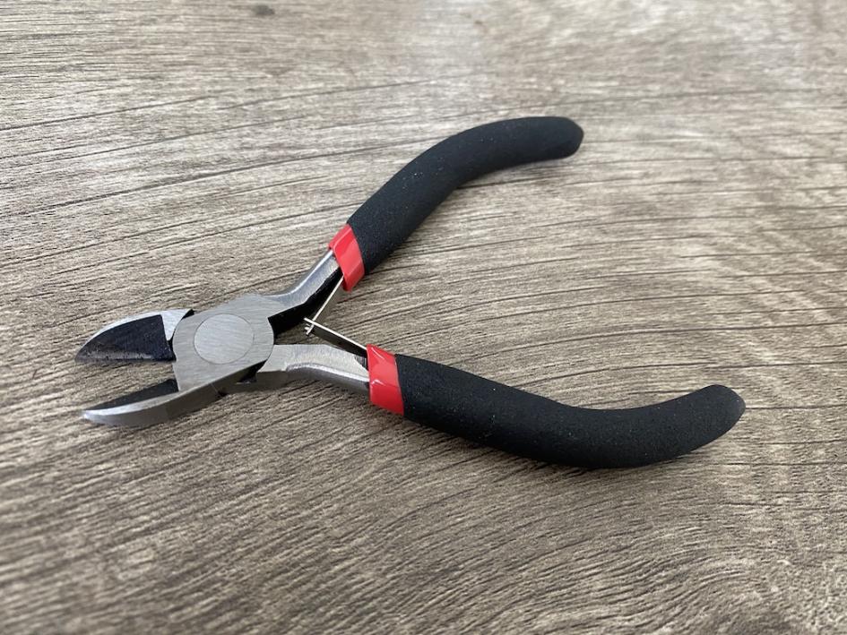

To meet all the requirements you described in your post, the H9 (low beams) and 9011 (hi-beam) halogen bulb conversions will meet your requirements. You have to have a pair of these small clippers and it takes about 30 mins to modify and install all 4 bulbs. You don't have to buy adapters, cut into factory harness, modify housings and you will get 50% greater light output, whiter light, will not blind people like most of the LEDs and cheap HID kits do, and can all be done for less than $50. There are all kinds of threads and pics on how to do this and it is truly a beginner level mod.

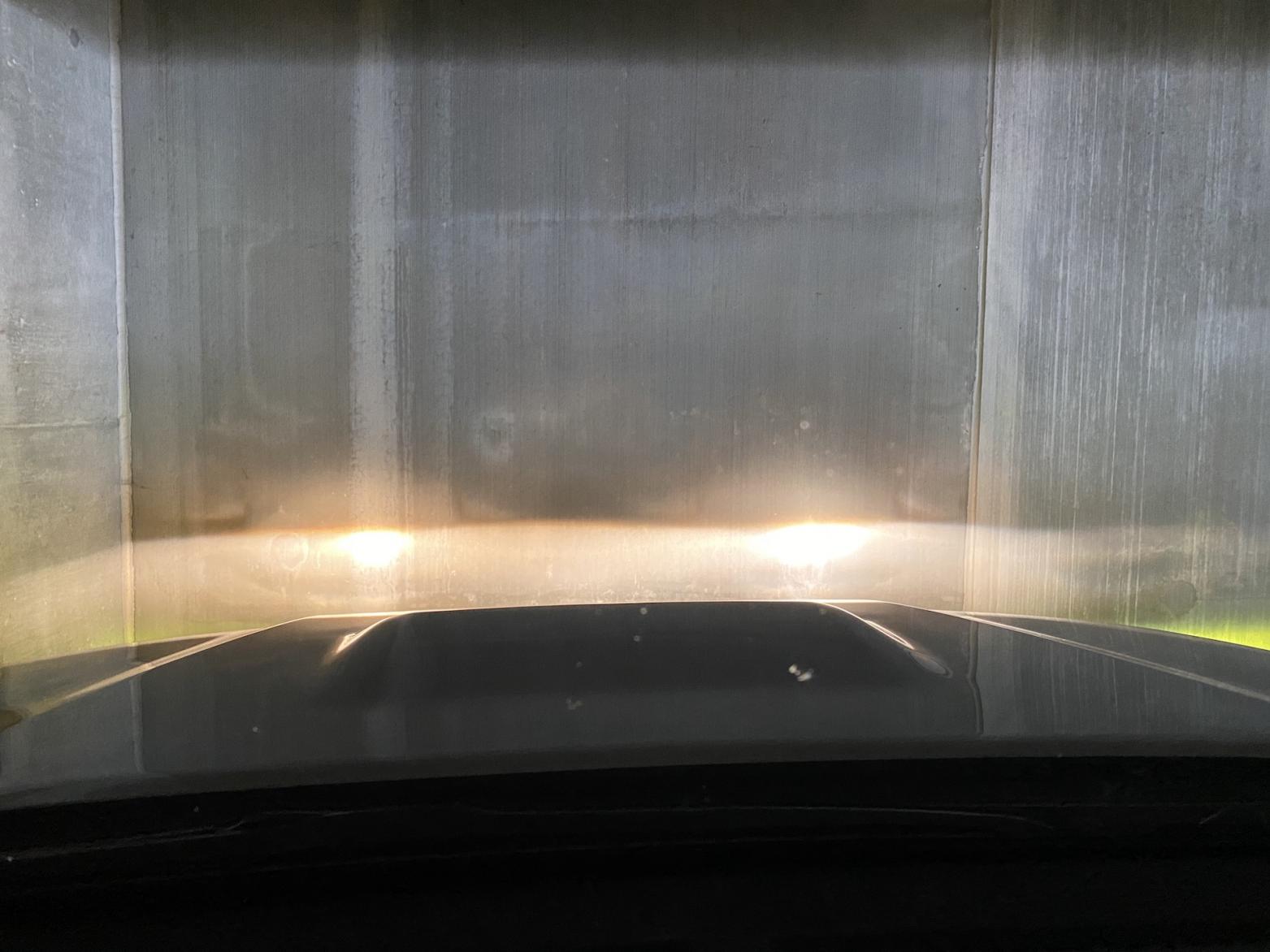

1st pic is low beam H11 on left, H9 upgrade on right with the LED fogs under. Concrete wall in daytime.

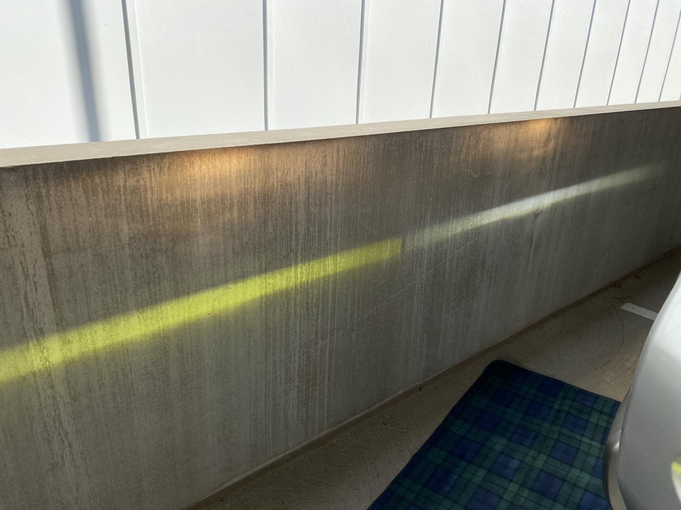

2nd pic high beam 9005 on right and 9011 upgrade on left.

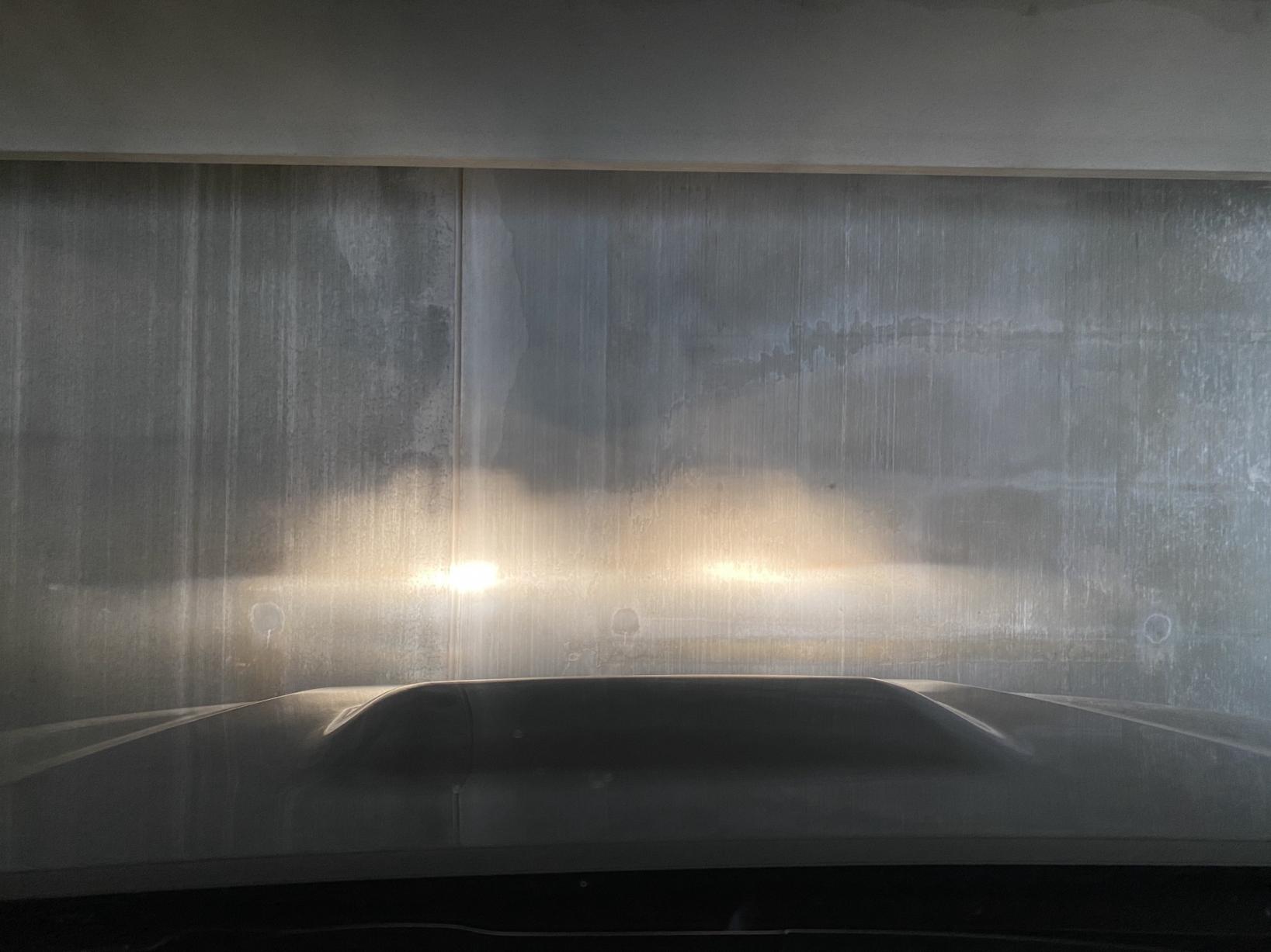

3rd pic is LED fogs with one side yellow Lamin-X also with original H11 low beams above the fogs.
